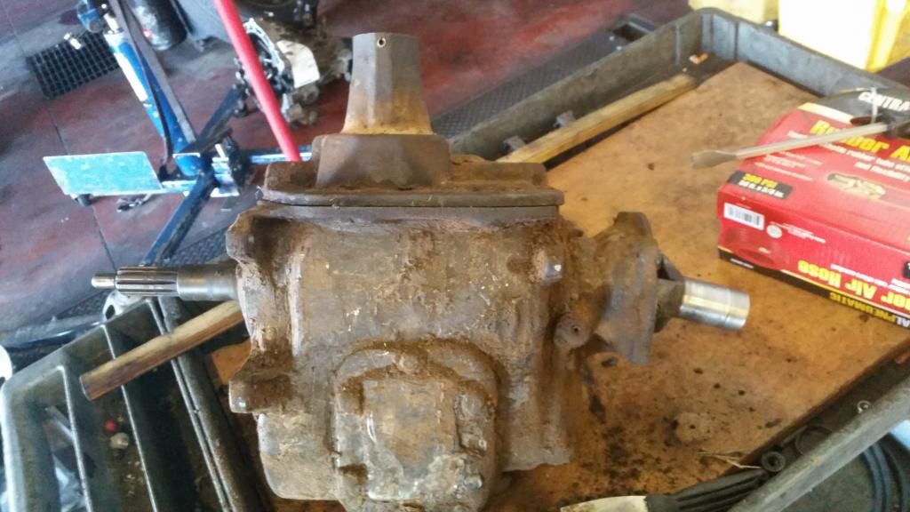

This trans came with my 1950 GMC 150 3/4T truck
The truck had a 58-64 235 chevy motor and this trans:
Trans Pic
What trans is this??? Truck hasnt hit the road, but it feels like a 4 speed
One piece drive shaft?
Totally open drive-shaft and u-joint(s)?
Is there a short piece of enclosed drive-shaft at the transmission?

its a two-piece drive shaft with u-joints
not enclosed in any way
yes, there is a splined stubby hanging off the [censored] of the trans
It looks like the "standard" SM420 transmission, which was used with fully open drive-lives from 1955 to 1967. And, the 48-54 version can be easily converted to open drive-line.
Post any codes/numbers that you can find on the transmission.

THAT's IT!
Thank you TCLederman!!
