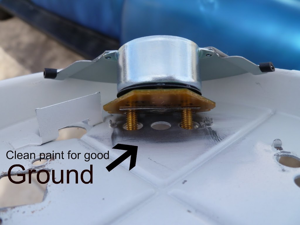

Make sure the back of the gauge cluster has a good ground
...pic...
