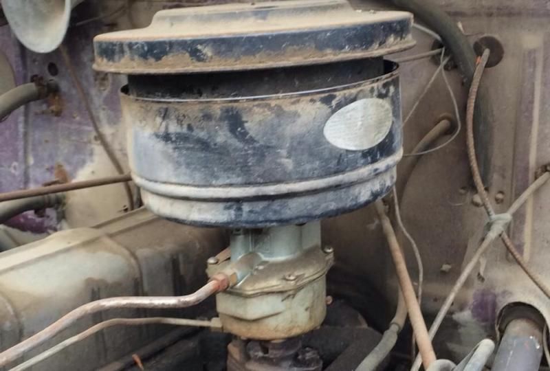

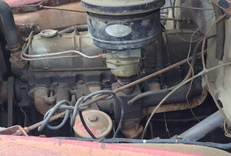

Here are some other views. view 2
view 3
view 4
view 5
view 6
It has the exact same air cleaner as my 1951 1 Ton. I think the side brace for it is still there. The carburetor appears to be the early design too with the thinner lip on the cover.

Although the oil distributor (or lack of it) isn't visible in any of the pictures I'm gonna bet it's a 216 due to the thin air horn casting and wide belt.
Stove - hang on to that book as I never had any luck finding the casting number from the 216 that was in my truck when I got it.
Fred - that filter housing was pretty standard on Canadian trucks. It was made by Donaldson and a repop sticker is actually available somewhere as they were used on other equipment such as tractors.

As pre68 Dave noted, that is not a 216 head. It is either a 235 head or a 261 head.
Sdilecce,
my engine is the original 216. Yours is not a 216 and would not be original to the truck but you might think of it as an upgrade.
