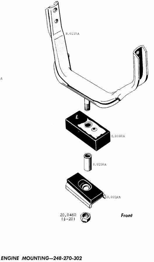

I have the mount assembly for the side mount block. The maintenance manual has an illustration of the mount here.
http://chevy.oldcarmanualproject.com/gmc/5559mm/5559mm359.html
The yoke on the front of these engines is missing the rubber cushion that would sit on the crossmember, and another rubber steel part that sits under the crossmember.

I just went and looked at my "side" mount. This amounts to a bracket that is " u "shaped. It bolts to both sides of the block and at the bottom center, under the timing cover, is your 1 bolt rubber mount. This could also be modified to work for you.
