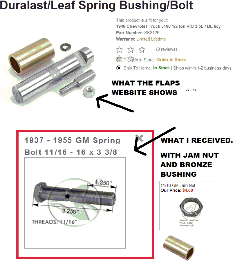

I ordered and received parts from a vendor to replace my shackle bushings and front/rear single bushings on my 1946 1/2 ton leafsprings. The bushing that goes in the 'front of the rear leaf spring' and in the 'rear of the front leaf spring' are what I am concerned
about.
If you see the picture below, the bushings/bolt/jam nut I received from a reliable vendor look very different from the ones the local auto parts store sells even though both state they are specifically for a 1946 1/2 ton Chevrolet truck.
I want to make sure I have the right parts BEFORE I start disassembly.
Any help is greatly appreciated. Thanks Stovebolters!
pics of what I got vs. what another sells
1946 Chevrolet 1/2-ton
More pix on Photobucket

What the FLAPS shows are king pins, not shackle bushings.

I don't know squat about the pre-AD trucks, but it seems odd that the FLAPS photo, if a kingpin, only shows one bushing. Kingpins need two bushings. And, if your spring mount has a place for the lock pin, I suppose both designs would accomplish the same task.

The one that the FLAPS shows are for 3/4 and 1 ton trucks,thats not a king pin set.Last year I replaced all the spring bushings on my 53 GMC project and thats whats in there.You'll need the other ones for a 1/2 ton. I've never worked on a pre 47 truck so I realy don't know what came in them.

Thanks everyone... I think what I have is correct for the single mount ends.

The difference is one is for a chevy and one is for a GMC...
Back in the forties GM was GMC wasn't it? As in GMC is the parent Chevy is the child.
If you look at GMC spring parts @ rockauto for the mentioned years you'll find the 'Bolt' type not the 'pin' type.
