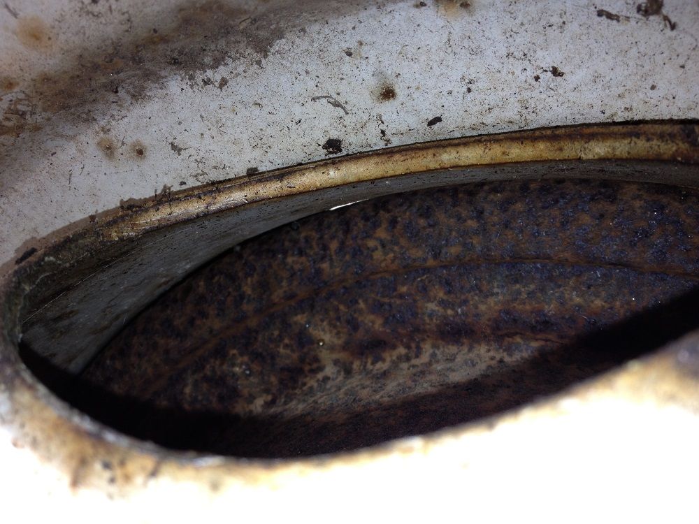

Posts: 197
http://i1067.photobucket.com/albums/u421/66Submarine/1963%20Chevrolet%20C-30%20dually/IMG_6689.jpg
Here's a picture of the gap on mine; you'd think it was touching if you didn't see the light showing through! Not the best angle or picture, but my point is that you need to have the drums cleaned off and the wheels snugged up before you can really tell if they'll go on, IMO. Not a lot of extra space there for misalignment or caked on grime!

Interesting that you say they hit before they got over the studs; for me they only get close when they are over the studs. Until that point the drums aren't close to the drop-center of the wheel where they would interfere. Mess around with it a little and see what you come up with.
