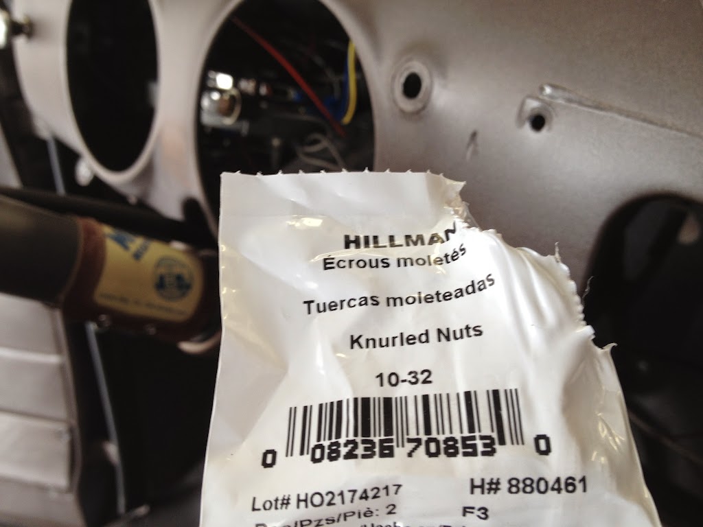

When I go back together with everything I'm going to use the knurled nuts you suggested a while back.
...pic...
...pic...
Should be a lot easier to remove the gauges that way in the future.
