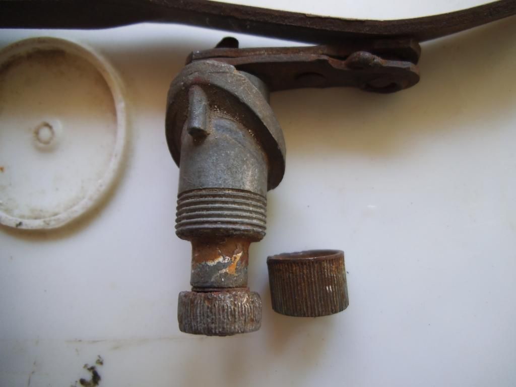

Well I got the package of little parts from Steve H today and am back in business.
There really wasn't too much to fixing mine. Obviously some would have a harder time than me.
As you can see from this photo:
Comparison

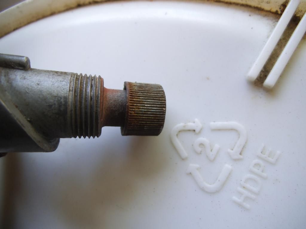

my current knurl was a good bit shorter than the one Steve H sent me. Mine was also pretty worn out which was why the wiper arm was just wobbling everywhere on me.

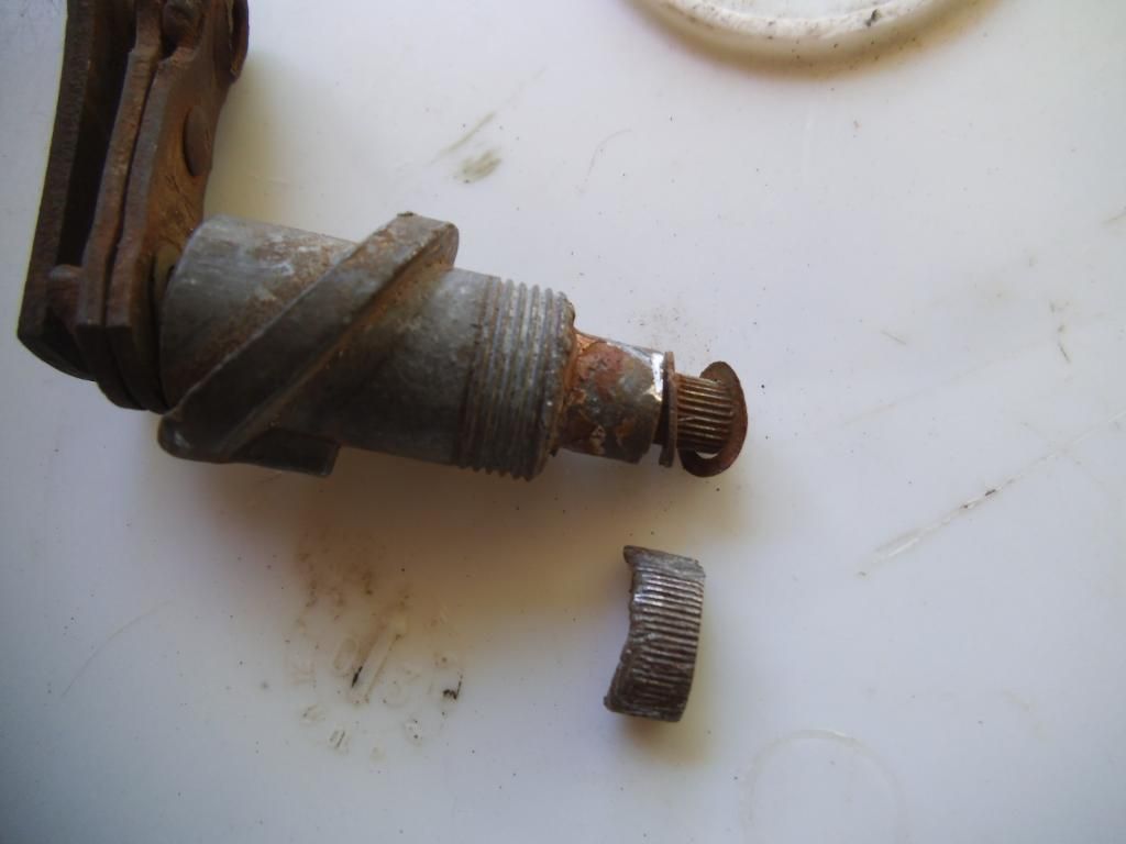

The top of the shaft was a little dented so I just filed it down smooth. Then I decided to use a nut-splitter to remove the current knurl rather than trying to pull it off. It only took two turns of the splitter to end up with:
Removed from shaft

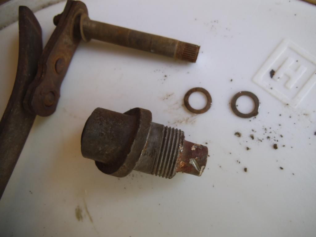

Everything then removed easily from the shaft:
All apart

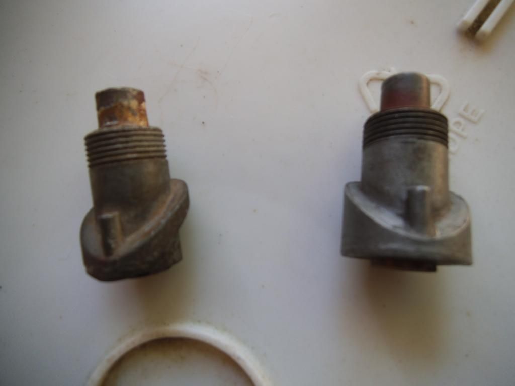

The base Steve H sent me was in far better condition too than mine. You can't really see the difference in the picture, but the interior of the housing on mine was pretty worn out:
Old vs Less Old
