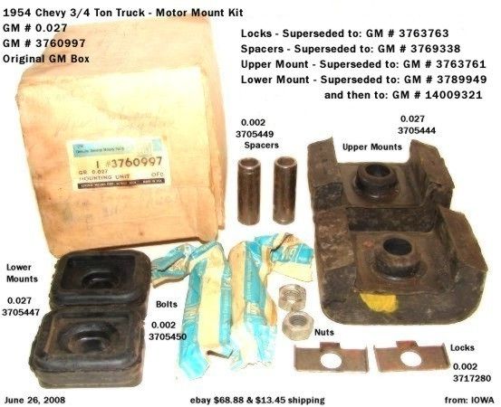

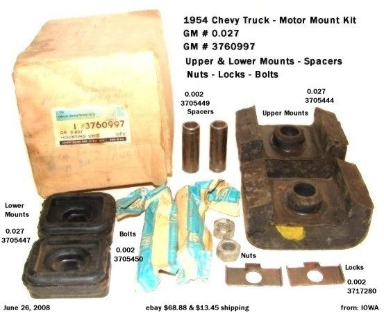

Greetings from New Jersey,
I covered the parts history of the
REAR Motor Mount ...BOLT in my first
post.
Most of the parts in the Motor Mount kit
are still available...GM NOS.
This post may help others find GM NOS
rear motor mount parts that are still available.
Photo of Motor Mount Kit
showing supersessions part numbers.
PIC@photobucket
http://i669.photobucket.com/albums/...OSMOTORMOUNTKIT3760997_b_zpsfa81b542.jpg

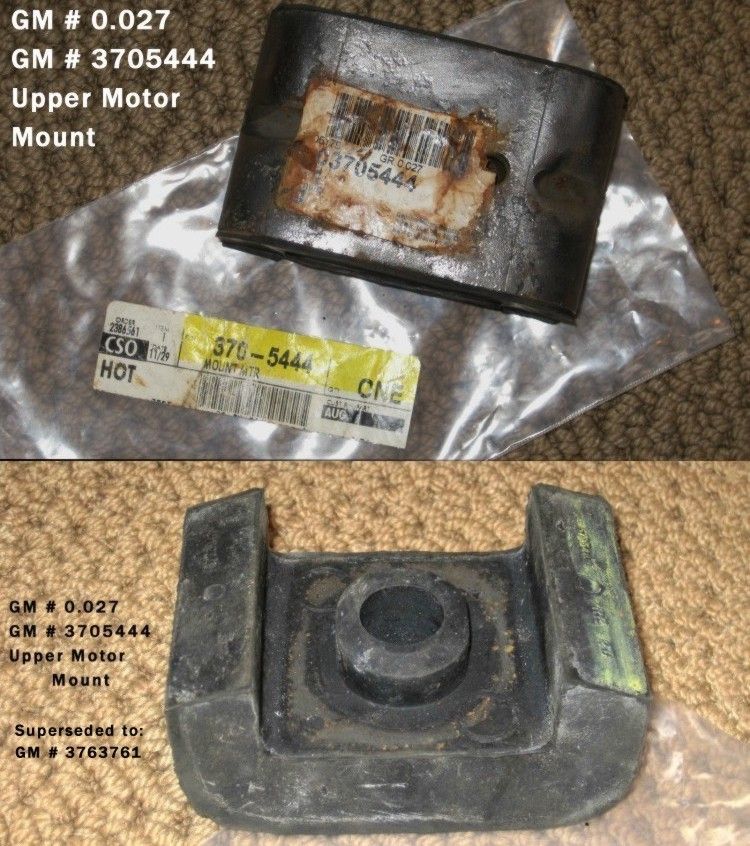

UPPER MOUNT
original GM # 0.027 - GM # 3705444
superseded to:
0.027 - GM # 3763761
Upper Mounts are hard to find GM NOS.
They are being re-produced by many vendors.
South Side Automotive
Minneapolis, MINN.
phone:612-727-2404
They have: ( 11 ) GM # 3705444 Upper Mounts
Ask for Jody or Heath
Upper Mount PIC@photobucket
http://i669.photobucket.com/albums/...Original_Upper_Mount_jpg_zpsbf3da714.jpg

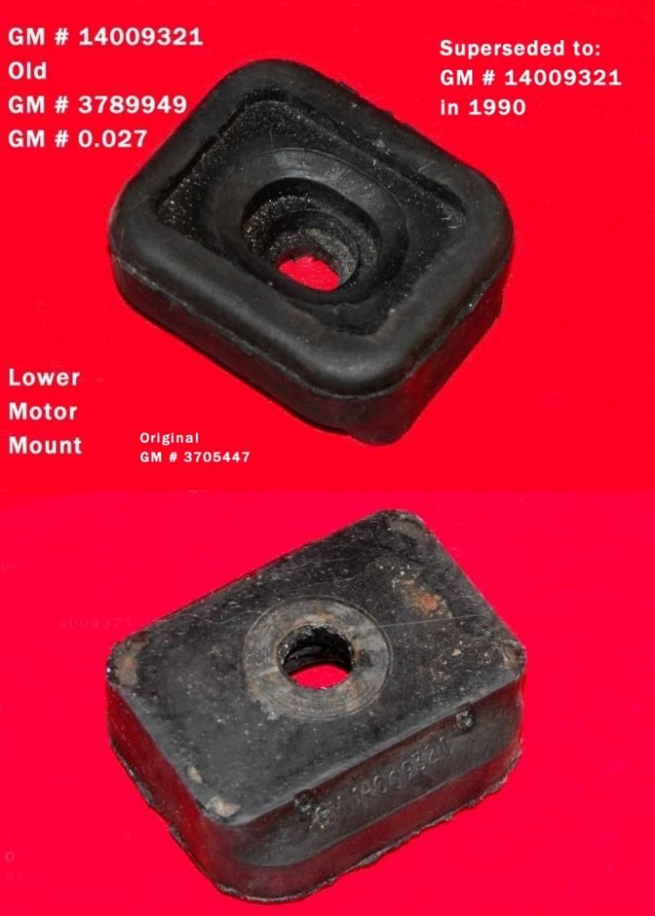

Lower Mount
original GM # 0.027 - GM # 3705447
superseded to:
0.027 - GM # 3789949
superseded to:
GM # 0.027 - GM # 14009321
Lower Mounts are available GM NOS.
Dan's Obsolete
Chinook, Montana
phone:406-357-2615
They have: ( 3 ) GM # 14009321
Dotson Chevrolet
Big Stone Gap, Virginia
phone:276-523-0130
They have: ( 1 ) GM # 14009321
Safeway Chevrolet
Burgaw, GA.
phone:910-259-5727
Nesenger Chevrolet
Medford, N.Y.
phone:631-475-0798
Minneapolis, MINN.
phone:612-727-2404
They have: ( 1 ) GM # 3789949 Lower Mount
ebay has ( 2 ) Lower Mounts
on ebay NOW.
Go to ebay & type in 3789949
There are ( 2 ) being sold for $8.00
Lower Mount PICS
http://i669.photobucket.com/albums/vv57/glp0329/Motor_Mount_2_/Lower_Mounts_ebay__zpsfc72596b.jpg
http://i669.photobucket.com/albums/..._Rear_Lower_Motor_Mount__zps2494fa27.jpg
http://i669.photobucket.com/albums/vv57/glp0329/Motor_Mount_2_/Lower_Mount_14009321_zps9e0be91d.jpg

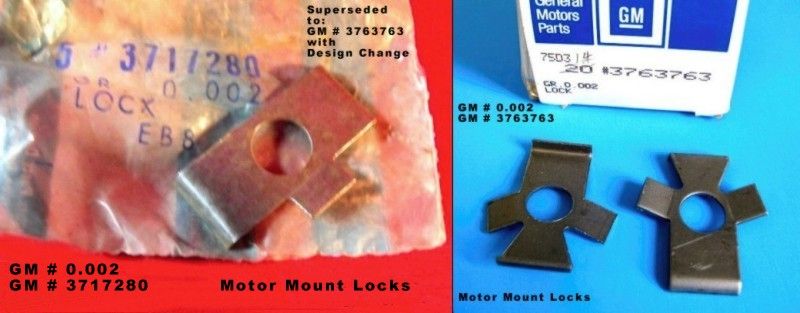

Motor Mount Locks
original GM # 0.002 - GM # 3717280
superseded to:
GM # 0.002 - GM # 3763763
with a design change - see PIC
http://i669.photobucket.com/albums/vv57/glp0329/Motor_Mount_2_/Motor_Mount_Locks__zps7f58dd5d.jpg
Motor Mount Locks are available.
