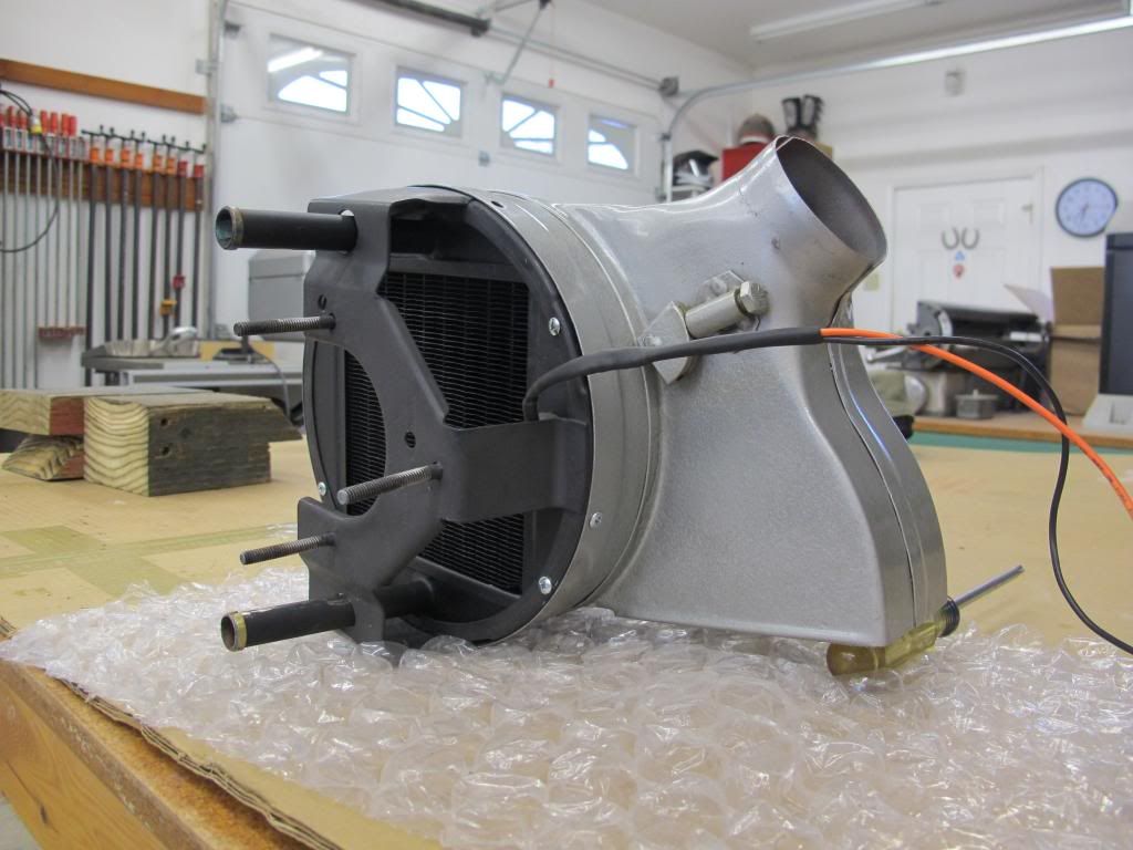

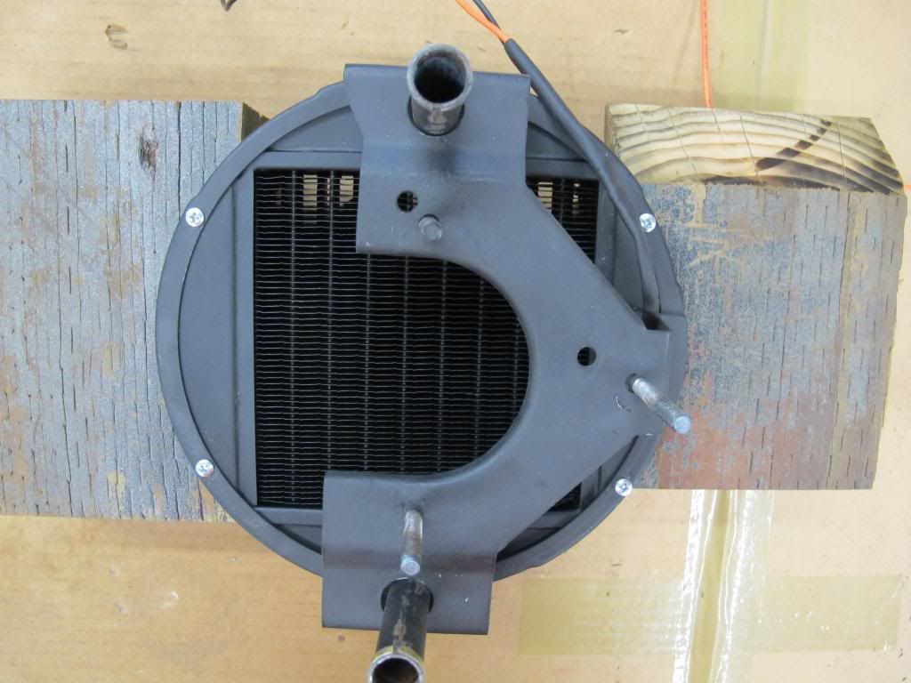

Heater as it arrived
Perhaps it is normal for one of the tubes to be angled out like this. One of the original cores I had was kinked about the same angle and one had both tubes straight. In any case the stock firewall openings will accommodate either width between the tubes.

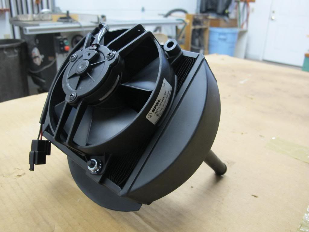

Compact and well designed
Nice tanks and a thick core

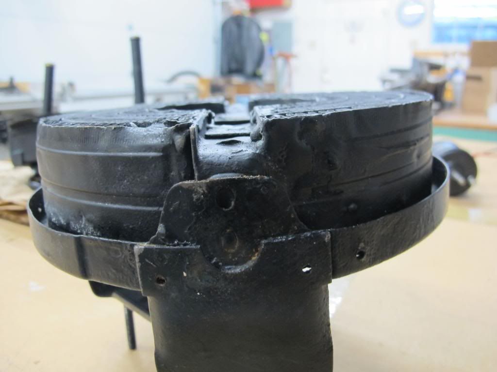

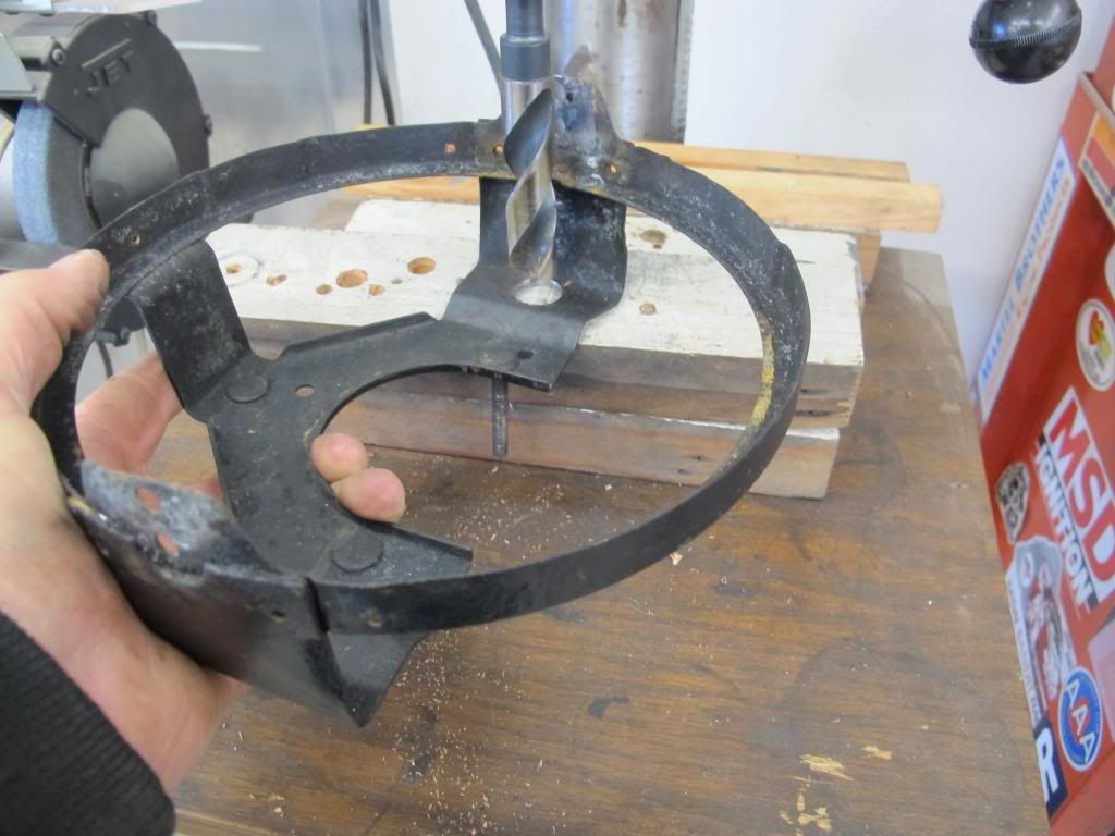

You need to unsolder the 3 bolt mounting ring on the original heater core. Just heat the 2 points where this ring is solder to the core.
Salvaging the mounting ring

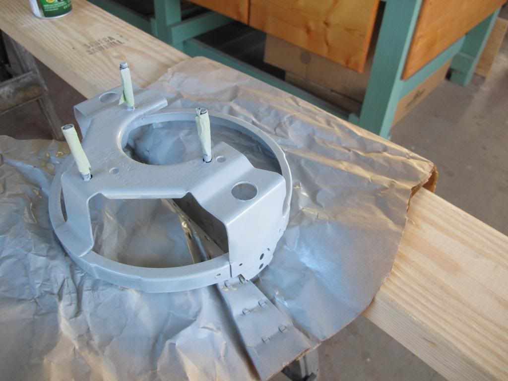

The new core has brass strapes soldered to the ends of the tubes which won't fit through the existing holes in the mounting ring. You could unsolder them until the ring is mounted, file them, use a dremel tool, etc. I just drilled them big enough with a 3/4" bit.
Opening the holes in the mounting bracket
I cleaned up the mounting ring and primered and painted it.
Cleaning up the mounting ring
I couldn't readily find a matching electrical plug for the one supplied with the new fan. There is also a large square hole cut in the supplied mounting plate presumably to pass the electrical plug through. I though that might have a slight effect on developing pressure for the defrost. I soldered some other wires to the cut off plug and found a round grommet that filled the square hole nicely.
New electrical connections
There are plenty of different ways you could attach the stock mounting ring to the new heater unit. I used 4 small sheet metal screws and it is quite firmly attached. Just make sure you are not screwing into the tanks!
Mounted to the original bracket

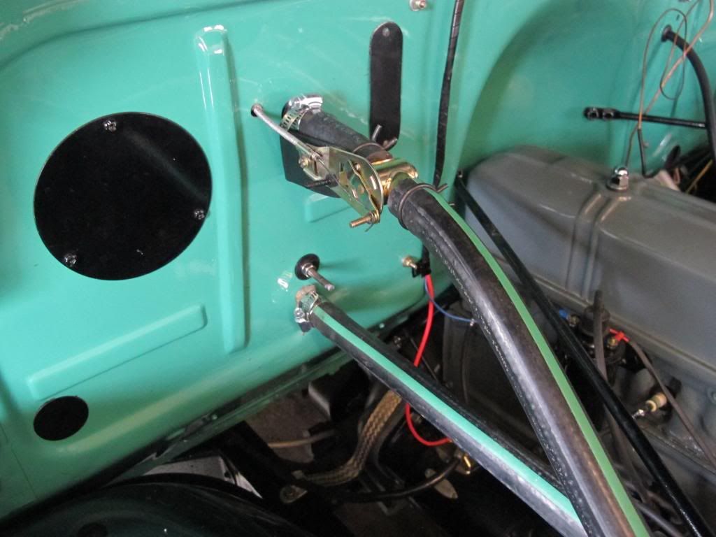

This is a simple valve I use to stop flow or control flow through the heater core. It works great!
Flow control valve

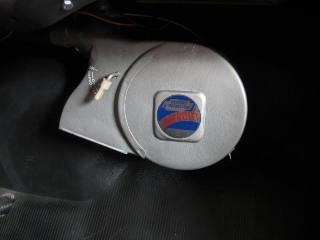

The heater back inside the truck. I have pulled this unit and another just like it enough times for leaks I think I could have done the whole thing start to finish in about 2 hours if I hadn't wanted to clean up the parts some.
Back in the truck

....where did you get that cut off valve. Local flaps???
I found the one I am using on ebay. I believe it is a stock part for a Hummer but I do not know what year or model. It was about $20.
Alvin,
The valve you asked about is a Four Seasons 74661 Heater Valve
This valve is on ebay now.
Also check this site:
Four Seasons 74661 valve

Wow,that turned out really nice. I would put a small rubber grommet in the firewall where your cable extends through.Looks really nice !!!!
