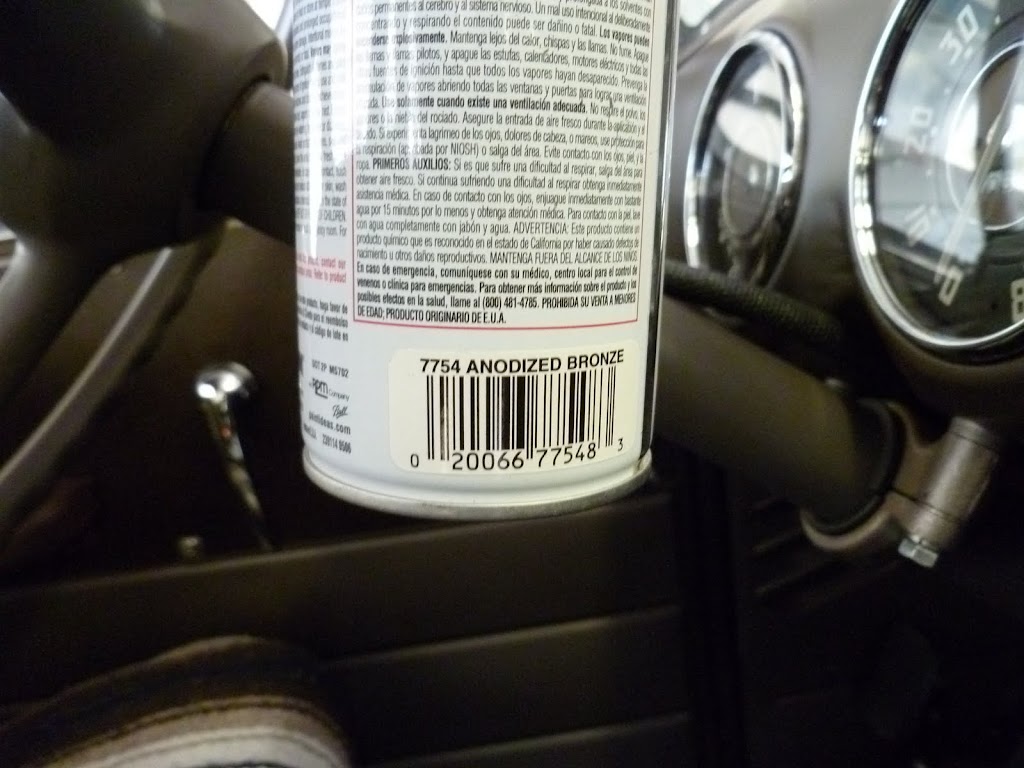

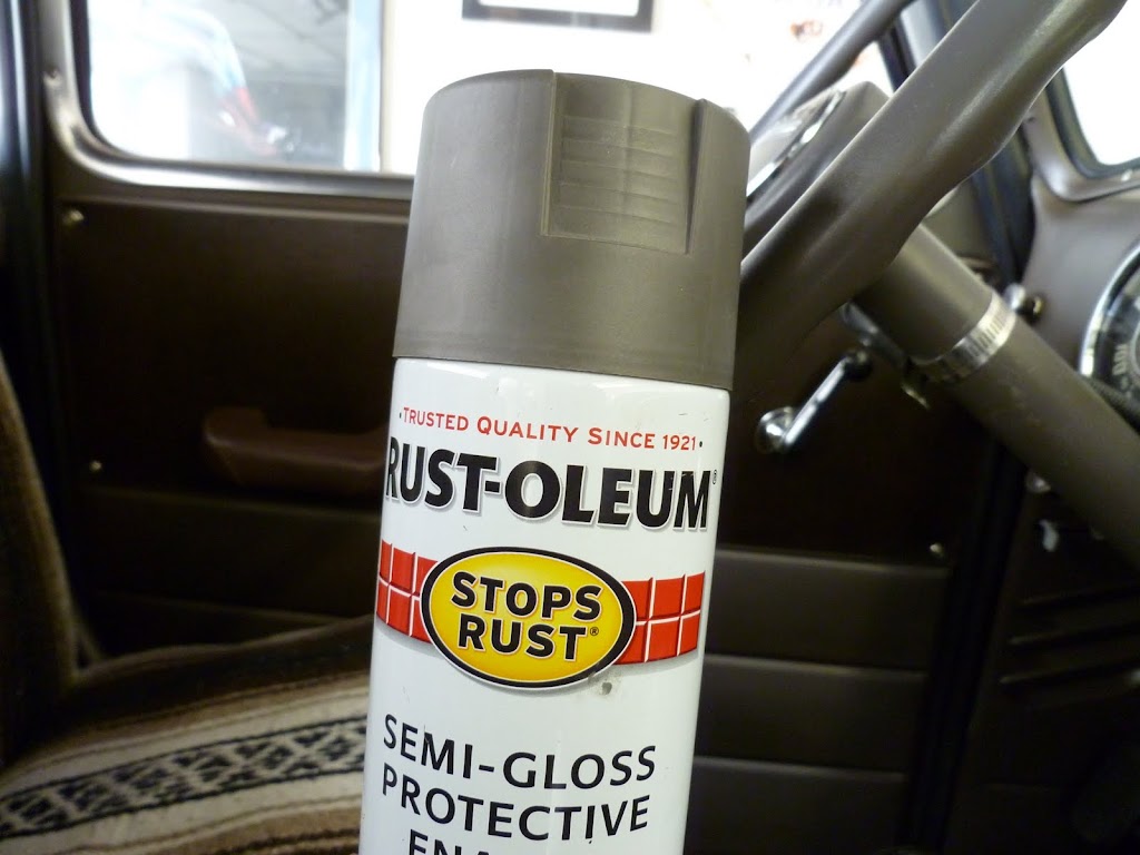

7754 is a close rattle match for steering wheel colum and floor shifter
...pic...
...pic...
...pic...

Huck, I saw this post and wanted to confirm something. I have a '48 3100. Looking to repaint the interior and the Rustoleum 7272 looks to be a good match. Can you confirm what interior parts would be all painted this color. I'm particularly interested to know if the steering column/column shift and/or wheel would also we this color. Thanks, Charlie
...pic... u
...pic...
...pic...
