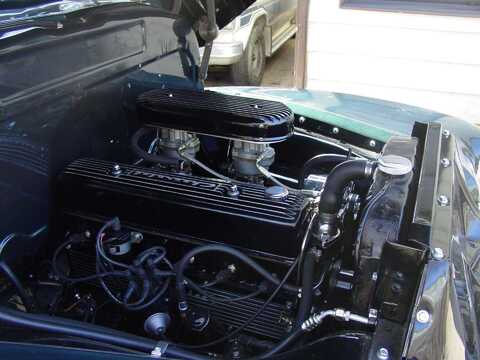

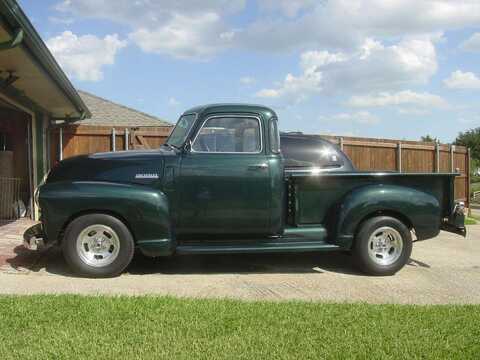

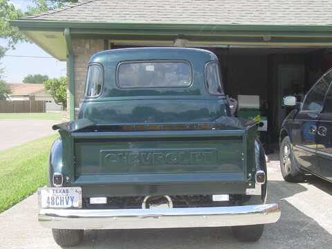

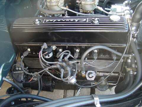

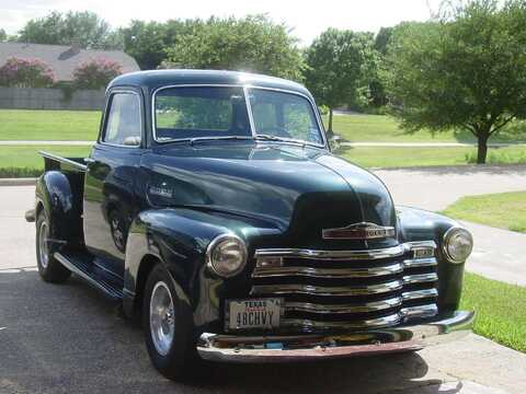

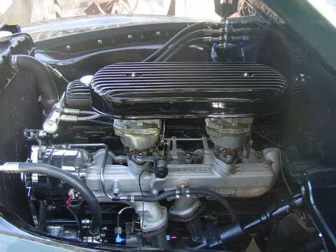

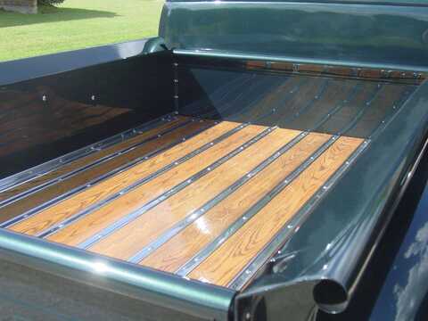

1948 5-Window 3100
My truck won 2nd in class at the Kansas City show a few years back (got beat by a Stovebolter with a magnificent school bus), but it's not a trailer queen. This truck is all original steel except for the tailgate.
Frame-off resto-mod, new corner glass, "modern" paint job with clear-coat (cab, fenders, bed pieces were all painted separately off the truck), too many powder-coated parts to mention them all, lowered four inches
Engine: 235 bored.030 over with a mild Isky cam, modified for a full-flow oil filter, ceramic-coated "original" Fenton headers (came off an old 60s hot rod), ceramic-coated Offy 2x1 manifold, two Model B Rochester carbs, powder-coated air cleaner cover, valve cover, and side cover, electronic ignition (not Petronix - actual EI), Vintage Air A/C, electric fan (switch under dash), dual exhaust with Thrush mufflers
Brakes: 4 wheel power disc brakes - the front has a kit, the rear is out of a Firebird (I think it was an '84), power booster is mounted to the frame on the driver's side
Drivetrain: S-10 Borg-Warner T-5 with overdrive, 3.73 limited-slip POSI rear, floor-mounted shifter between the two bucket seats, this truck will run 65 all day long at 2,000 RPM with air (and has), chrome diff cover, Goodyear P215/R15-75 radials, slotted mags (I don't know the make, but they remind me of the old Cragers from the 60s.)
Suspension: Front mono-leafs from Patricks, rear stock springs with mounts reversed, gas shocks all around
Steering: stock, no power, with a very large steering wheel to make slow turning easier, Ididit column with tilt and turn-signal
Battery: mounted under the frame on the passenger side in a tray that can be lowered for service, optima red-top AGM battery with Optima digital trickle-charger
Interior: adjustable bucket seats with seat belts, tan and black interior, carpeted floor with tan and black Chevy mats, dolphin white-faced electronic speedometer, dolphin white-faced four-gauge cluster (oil pressure, water temperature, volts, fuel), Sunpro Super Tach II mounted under the dash, no radio, no stereo, no DVD (see - there's still things you can do to this truck)
Bed: oak boards, marine-varnished, stainless hardware, stainless hidden latch tailgate from Mar-K
Stainless: rear taillight housings, locking gas cap, door trim, bolts everywhere, including bow-tie stainless bolts on the upper radiator housing mount, stainless braided fuel lines
