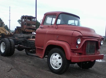

I was immediately drawn towards the far right hand corner of the lot as we went through the entrance. At the end of the row of vehicles, I could see only the roof of what appeared to be a 1955 / 1959 truck. When I got over to it, it was partially buried in a tomb of sheet metal. It in fact was a "what?"
I could make out that it was a big truck with duals and a kinda funny but very solid cab. After getting the hood open, I was more confused. There was clearly a v-8 with GMC decals on the valve covers. So, part of the mystery was solved.
I put pressure on the fan belt and turned the fan, the motor moved. I yell at Stuart to come over and asked if he had any idea. He replied, "Not really." (He is 30 years my younger.)
Still confused and all the more curious, I opened the door to find a GMC hood ornament on the weathered but not too bad condition seat. There was a complete dash, a 4 speed shifter and emergency brake handle next to it, a five gallon bucket with head light bezels, clearance lights, turn signals lenses, side emblems, nuts and bolts, and mirrors on the passengers side floor board. But no grille, in, on, under, or around to be found. Overall, a clean, straight, complete truck with 22,000 on the odometer.

Three weeks later, I had the rest of the cash. So, I called my friend Joe, who has a truck and trailer. Then I called Dick and told him we were on our way. I had a big smile on my face when we pulled into the yard. We detached the trailer, and pulled the GMC from its tomb. That's the picture up above.
