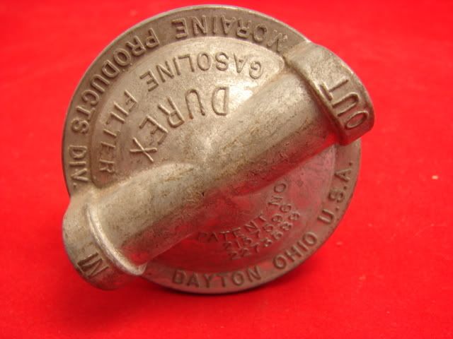

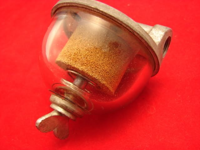

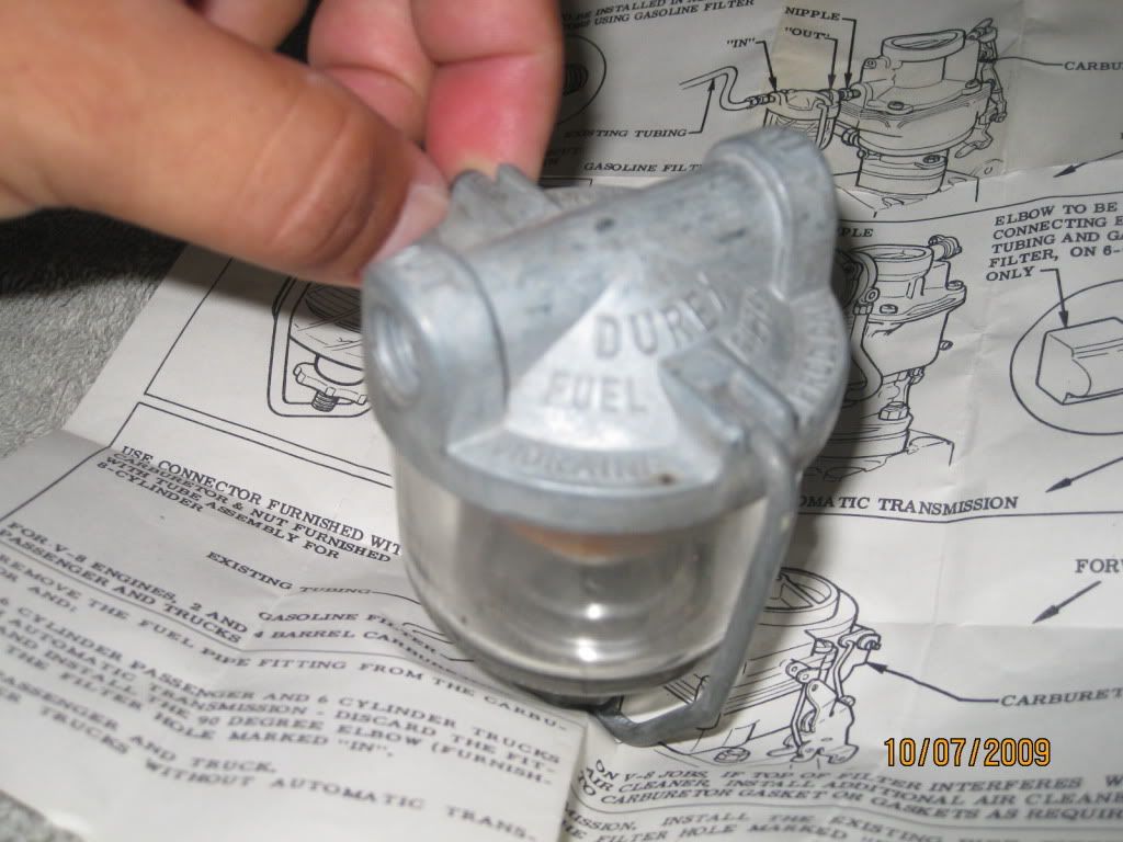

GM offered a Durex Moraine #986128 gasoline filter as an accessory installed by the dealer 1947-1949. The filter had a glass bowl with a winged thumb screw through the bottom of the bowl. The filter element was porous metal. It's pretty cool looking.
> Durex 986128 gasoline filter - April 1949 Motor Age ad
Although this photo is in the 1951 Accessories Installation Manual, GM did not produce the filter in the pic after 1949. Durex Morane #986128
> Pre-50 filter in '51 Manual
> Chevrolet Accessories for 1948 "Filter Unit - Gasoline" #986128 (price for 12 filter units)
> 1948 Chevrolet Accessories Brochure "Gasoline Filter Unit"
> 986128 top view
> 986128 side view
> 986128 bottom edge
> 986128 parts (missing gasket between bottom of bowl and thumb screw)
> Durex 986128 on Curt Warren's 1948 1.5-ton Loadmaster

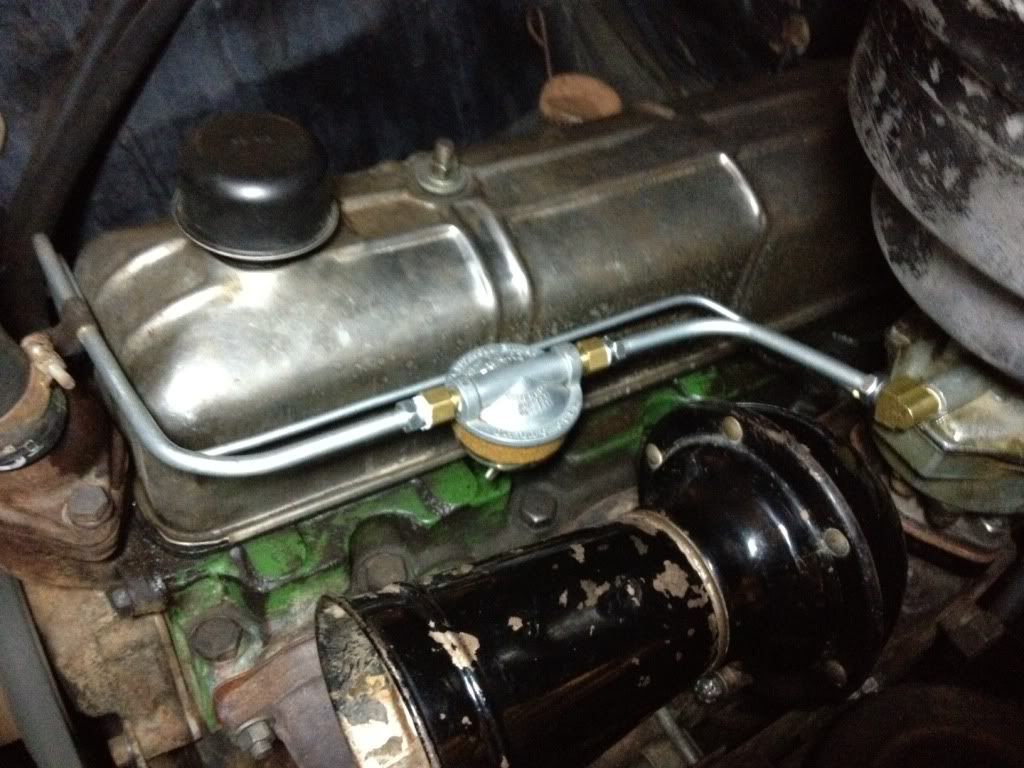

In 1950 GM changed the design to a glass bowl with a bale and thumb screw. Durex #986399. A special 60-deg fitting was included with the filter in 1952 to allow it to clear the automatic choke on a PowerGlide passenger car and the number was changed to 986640. I don't know of any modern supplier that sells the 60-deg fitting.
So either of the filters would be appropriate for your 1949 truck, although #986128 would be a little more correct . Brad is correct - these filters are on ebay pretty often. Durex #986128 is less often.
> Durex #986640 in 1953 ad
> Durex #986640 on my '54

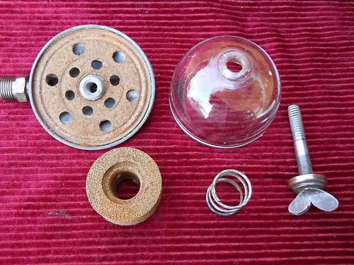

LEFT TO RIGHT: Carter, AC repro, Durex 986640, Durex 986128
> Glass bowl filters (spring is incorrectly upside down in the Durex 986640)
> Same filters open

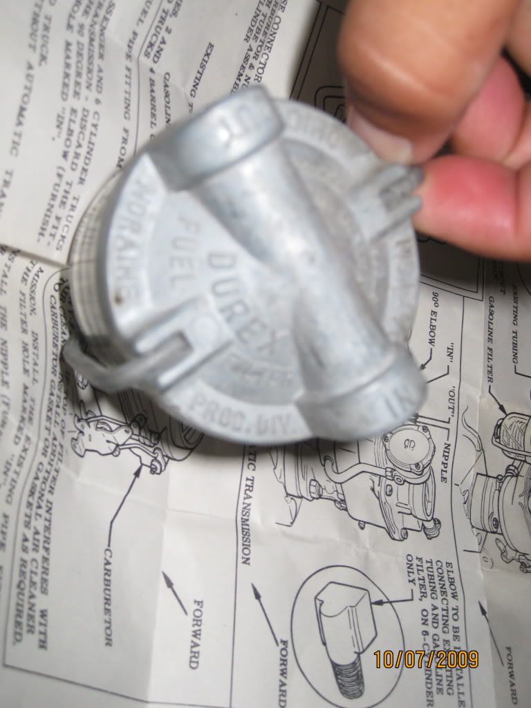

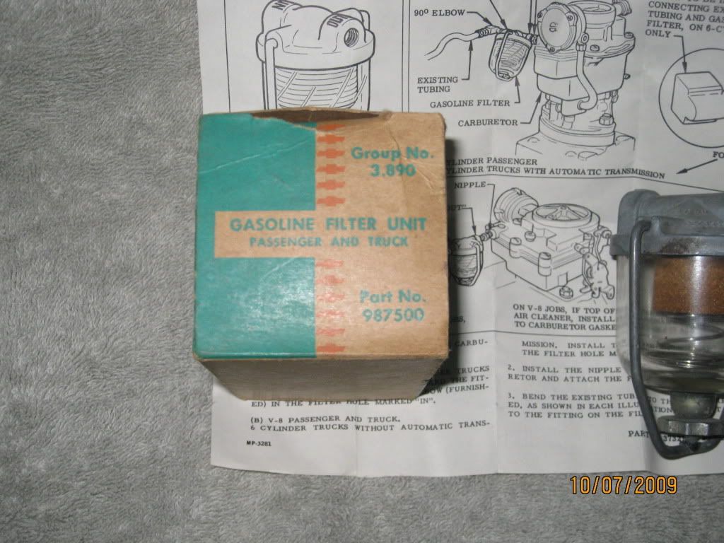

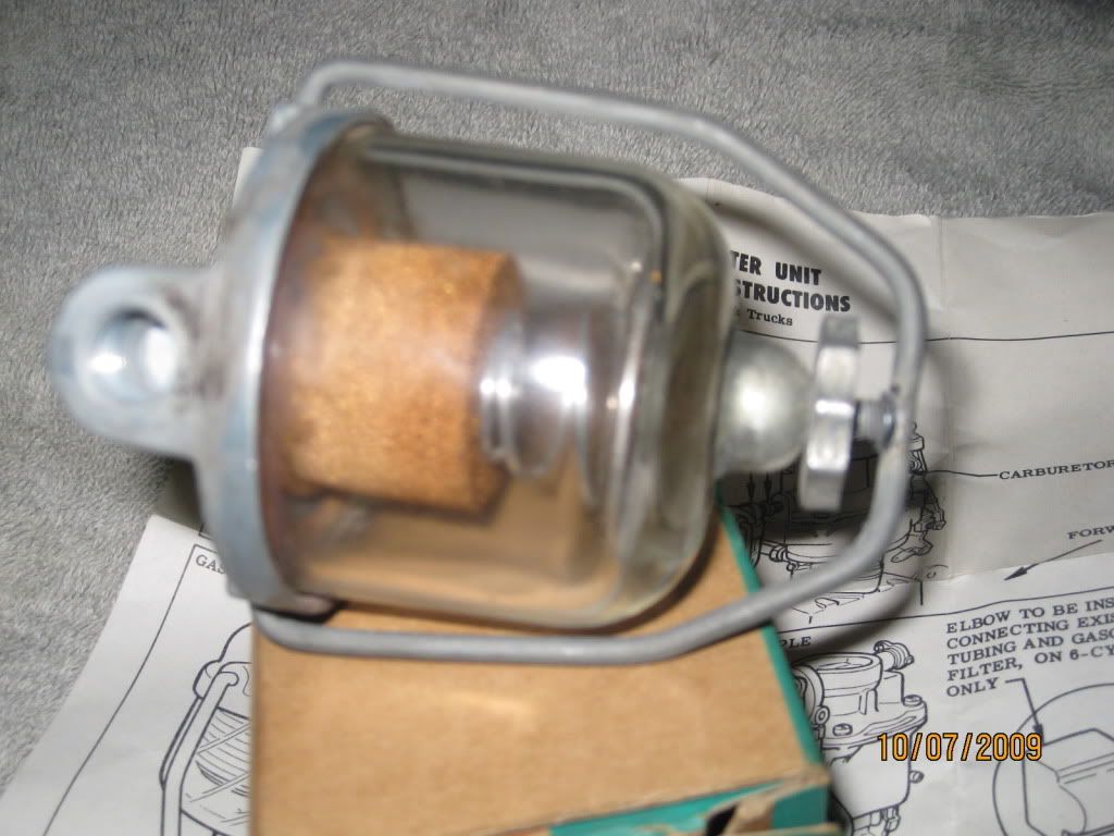

#987500 diagram in the instructions looks like a dome-top AC filter. The photos are a Durex Filter. The filter may have been in the wrong box(??) Not my photos.
http://i721.photobucket.com/albums/ww213/eskimoe1/IMG_6809.jpg
http://i721.photobucket.com/albums/ww213/eskimoe1/IMG_6802.jpg
http://i721.photobucket.com/albums/ww213/eskimoe1/IMG_6808.jpg
http://i721.photobucket.com/albums/ww213/eskimoe1/IMG_6807.jpg
