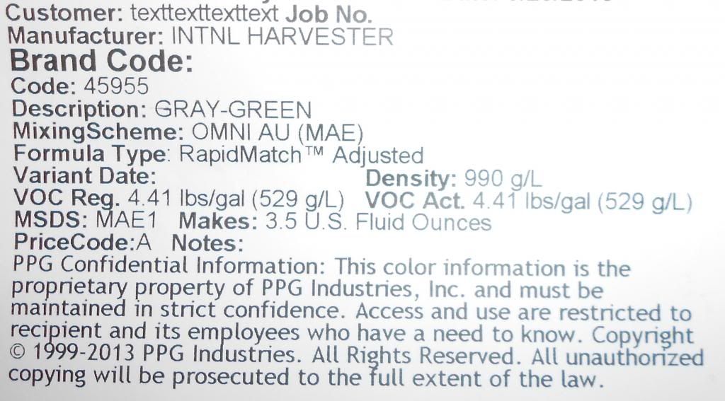

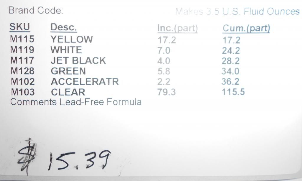

I went to my neighborhood PPG dealer and they tested the 1954 Chevy truck visor underside paint.
The results are shown below on two labels:
label A
label B
The results are just data from the RapidMatch X-5 Spectrophotometer, I have not mix any paint yet, to match up with the actual original underside paint sample I provided.
According to the PPG dealer the results are a fairly accurate and might need a little tweaking to get a exact match if needed.
It would be helpful if someone can decipher what the data means?
My next step is to possibly mix a small sample to see if it matches the original underside paint sample.

The first post shows the closest color that the formula matches in it's library.
The second one is the "meat and potatoes". It lists the pigments by their name and code. Then it tells how much pigment by weight there is of each and the last column is the cumulative weight. Basically, they put the empty can on the scale and zero it out. They add the first pigment until it gets to the weight shown, the second pigment until the next cumulative weight is reached and so on. When all is done, you have a can full of paint ready to be shaken to mix.
