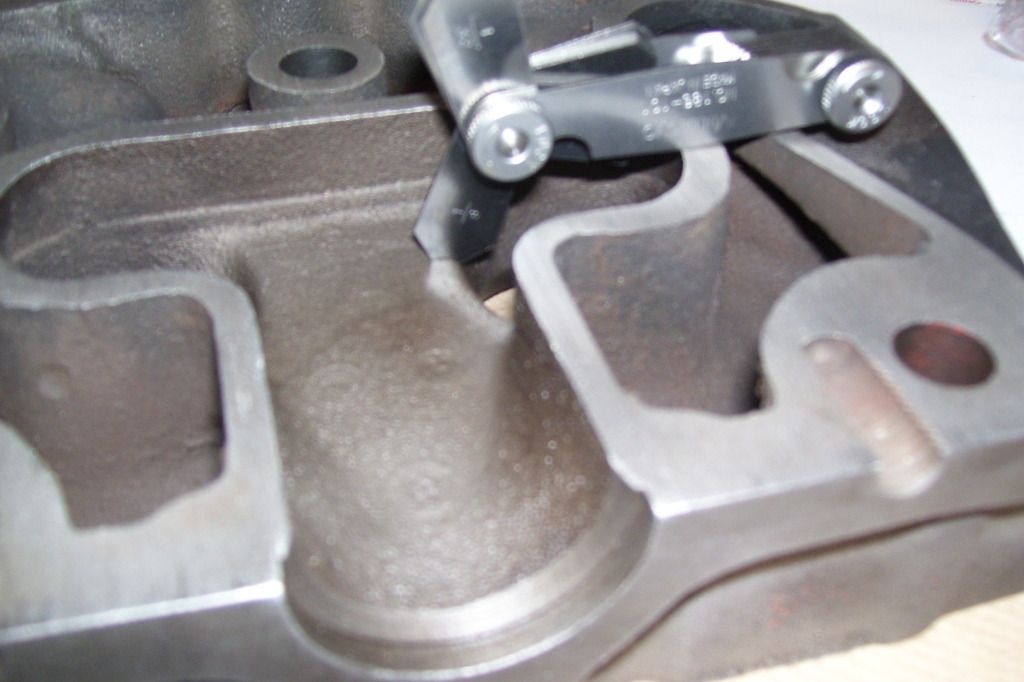

I'm still learning a lot on this site and I appreciate your teachings. My 261 has an 848 head on it. When I sent it to get rebored and hot tanked I was asked if I wanted to deck it. As I was unsure of the consequences I declined. The block could be smoothed out up top but what would that do for valve clearance on the head to deck surface with this head?
Any head milling or block decking is going to move the valves and the pistons closer together. So will the installation of a "shim" head gasket instead of the sandwich-construction "no retorque" style of gasket. All those dimensions need to be considered when building a high performance engine with a radical cam profile- - - -not so much with a stock engine unless a lot of material is removed somewhere.
The 848 head has the equivalent of a .100" milling job on the earlier head, but the 848 compensates for the closer valve/piston relationship by sinking the intake valves further back into the head to preserve the valve to piston clearance. If the earlier head is milled to get the same compression as an 848, the intake valves must be recessed to prevent interference. Shrouding the valves hurts intake flow, so the compression increase comes with somewhat of a tradeoff in breathing ability. The stovebolt head has port shapes that suck like a Hoover upright vacuum cleaner, so nothing much short of supercharging is going to help the gas flow much!

I'll throw in my 2 cents on this topic. I flow bench tested an 848 head with various CNC machined alterations and sadly none of them made an appreciable improvement in flow. The reasons for this can explained in this picture. The short side radius is only 1/8" and as flow is increased the charge bounces off the back wall and becomes disorganized. Enlarging the runner from the intake (as documented by Frank McGurk)actually sacrificed velocity and was detrimental to flow numbers. The guy that did the testing for me had considerable racing engine experience and tried putting a clay "wedge" on the back wall of the port to help direct flow but it didn't really help due to the overall poor shape.

Exactly what most of us have been saying- - - -these engines are built for low-end torque, and efforts to create high speed HP are pretty much doomed to fail. The cutaway reinforces what we've been told about just how futile anything other than maybe a little pocket porting right under the valve will accomplish.
Thanks for the pics!
The discussion about horsepower and torque might be interesting and might be fruitless, and it might be of more interest in the Hi-Po forum,
However, one question asked above is closer to being a matter of physics (I think) and it has to do with standard equipment/parts: what might be the difference in compression that would result from placing a stock "848" 235 head on a stock 58-62 261 block?
