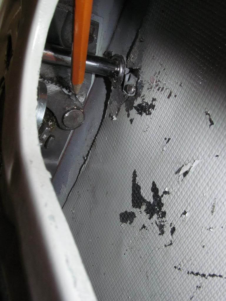

Not sure if this will help but I had a very similar problem. If you take a close look at the lock mechanism, you will notice a small caul with notches to lock it in place when the door has been closed. Its kind of like a ratchet action. Mine was worn so bad that all that was left was lines where the notches should be.
I took a punch and removed the caul, put it in the vice, re-filled the teeth put it back in, and what a difference. My door shuts really well, no more rattling!! I could be wrong but I think most of us could avoid buying after market locks if we would rebuild them. I don't think alignment is always the problem. Hope this helps

You just need to remove your lock mechanism from the door. You will see the notches right away.
http://i150.photobucket.com/albums/s107/vickraft/003-4_zpsf3a48171.jpg
The attached pic shows the repaired portion. If the ratchet mechanism is worn it cannot hold the door shut and sometime we think its an alignment problem. It will never line up if this part is worn. Once this is corrected alignment will be just a few tries.
