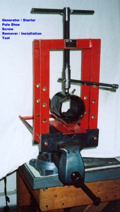

on the Internet for over 30 years! and not clogged down with Ads! Again, thanks! | | | | Joined: May 2005 Posts: 8,878 . | | . Joined: May 2005 Posts: 8,878 | Neat, I've never seen those tools but they make perfect sense.
If you're not setting out to do this all the time then for the fancy screw driver can you use an impact driver? That's what I would use for lack of the fancy press contraption.
The pole spreader you might also get by every now and then with a set of "folding wedges" made from wood.
Grigg | | | | | Joined: Feb 2011 Posts: 1,363 'Bolter | | 'Bolter Joined: Feb 2011 Posts: 1,363 | Wow did a search and can't find much on these. You could use a regular bench type drill press and a modified screwdriver tip to fit and a wrenching area on it, setting the case in a V block made from wood or ? . The wood or plastic idea above is a good one, and likely you will need to use longer bolts or studs to aline the threaded holes as your expanding the windings into position. You may get by using a setup of bolt and nut as a jack of sorts to spread it too, of course the contact ends need some sort of padding to not damage the laminations.

| | | | | Joined: Jul 2007 Posts: 444 Shop Shark | | Shop Shark Joined: Jul 2007 Posts: 444 | Denny Grahm, Did you make the pole shoe screwdriver ?
I like what I see. I can use it in my drill press too.
How can I get one ?
George | | | | | Joined: Oct 2006 Posts: 9,671 'Bolter | | 'Bolter Joined: Oct 2006 Posts: 9,671 | You do realize that you’re getting into an area that is a little beyond the average job a back yard mechanic usually tackles, but here goes. This is the easy part, actually that is just a coupling nut. I formed a radius on the heads of the bolts in the bench lathe to get them close to the inside contour of the pole piece. That cast factory unit that you pictured would be nice if you were working everyday with starters/generators but it’s basically just to keep from distorting the housing when you put it in the pole piece screw press. Also it helps to seat the pole piece when mounting a new set of coils.
This is where it gets tricky if you don’t have access to a machine shop. I don’t know if you will be able to put enough pressure down in a drill press. In the mill I can lock the quill in the up position and adjust the knee to put pressure on the screwdriver while I turn it with a wrench. The Screwdriver needs to be made from a relatively tough material or it will just shear the blade off when you turn it. Something like 4140 hex stock will work and is available from vendors like McMaster Carr. The blade in the picture was just a piece of hex I dug out of the scrap bin and I did have trouble with it shearing on a later screw because of the material and the shape that I hurriedly machined out. The material should have been tougher and the shape should have been much like that of a drag link socket, which might even be made to work. So in answer to your question, “where can I get one”, you will probably have to find a machine shop that can make you one or adapt something, like the drag link socket. DG
