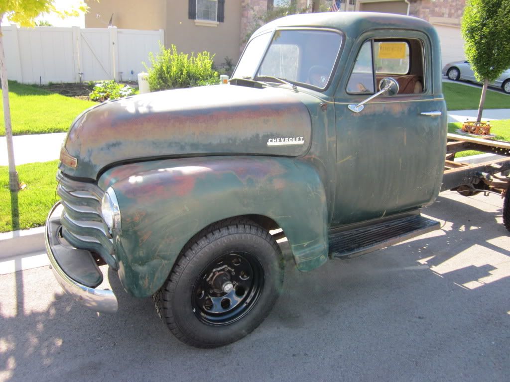

On my 3800 I tried to match tire heights when changing over to tubeless. I went with a 265/70R17. That's about 31.5" tall.
driver side fender
passenger side profile
I wanted room for my hands in case I ever had to change a tire.
