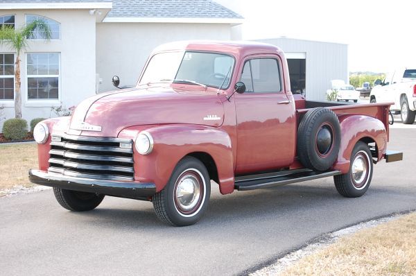

I think I might have figured out that I can post a link to PhotoBucket here to show you all my brand new/old (purchased today) 53 3600 ... Isn't he beautiful? smile I may be a little prejudiced ... but very happy with the purchase ... I think it was a good deal and I am looking forward to many happy hours driving this truck. I am sure I will be on the forum with many more questions down the road. Look forward to meeting more of you with this same love of vintage trucks. Here is the link for pictures:

Seems your link isn't quite working. However, I think I can help, if you don't mind. Beautiful truck, by the way.

Wow, Jeanie, I can see why you are a happy camper. Looks like everything is there. Enjoy it.

Very clean looking truck, you ought to have fun with that one.

Beautiful truck!
