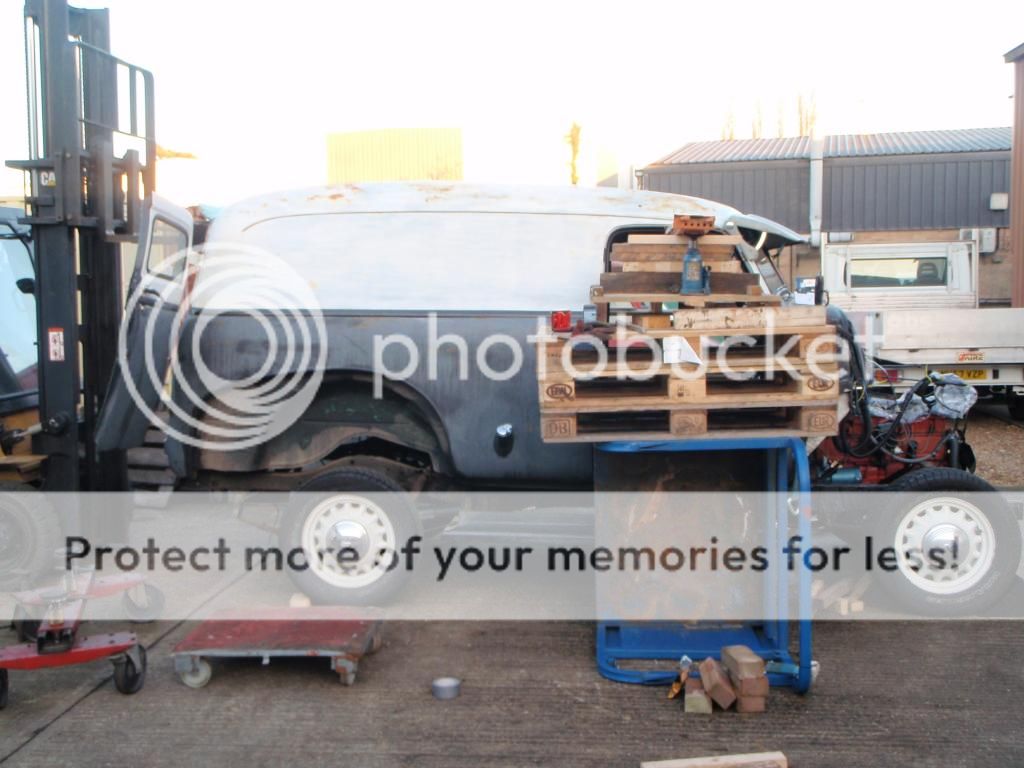

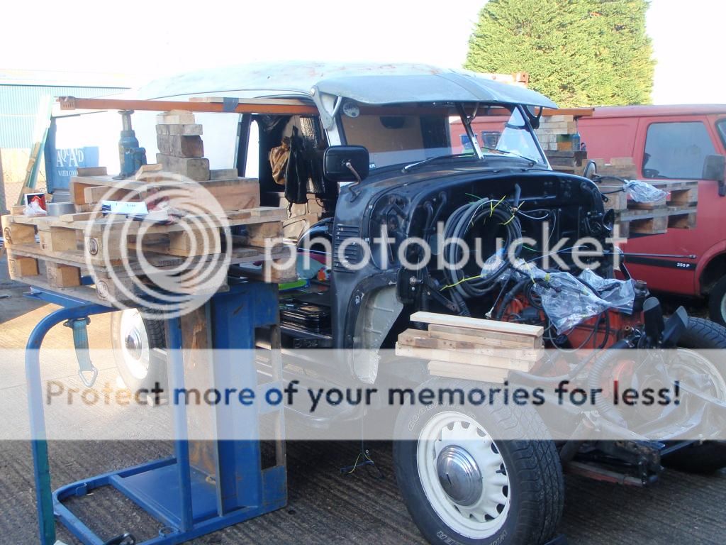

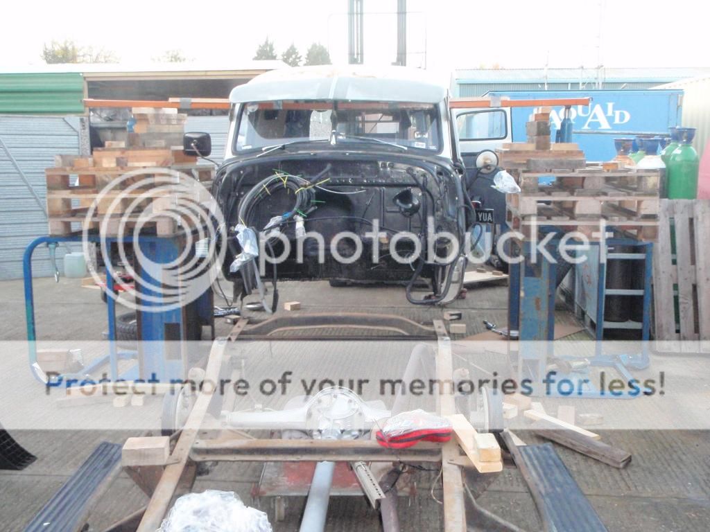

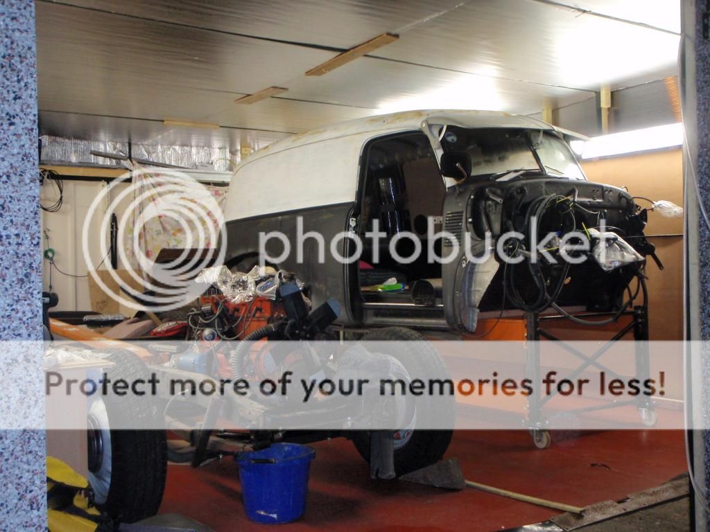

Hi guys, ive got my truck stripped down and almost ready to lift the body off.
still got to remove the doors, am going to leave front glass in?
chassis ive still got engine in, but all removable metal work has gone...from fenders both front and rear,bonnet ect.
im really worried about lifting the body off, ive got the use of a fork truck..so was going to put that in the opening of the back doors (and lift with protection and wood across the folks)..
then through the front door opening..span a large piece of wood and jack it up pushing against the top of the door openings??
any thoughts on this!. ive the week of work to tackle it...!
1953..panel truck.I love my truck!...

yes easy, put some narrow pallets on the forks to take up the curve to the roof ribs, rope from the mast thru the front doors to keep it from tipping forward, Bob's yer uncle grin

thankyou very much chaps...will try post some photos to show you what im up to for the winter!

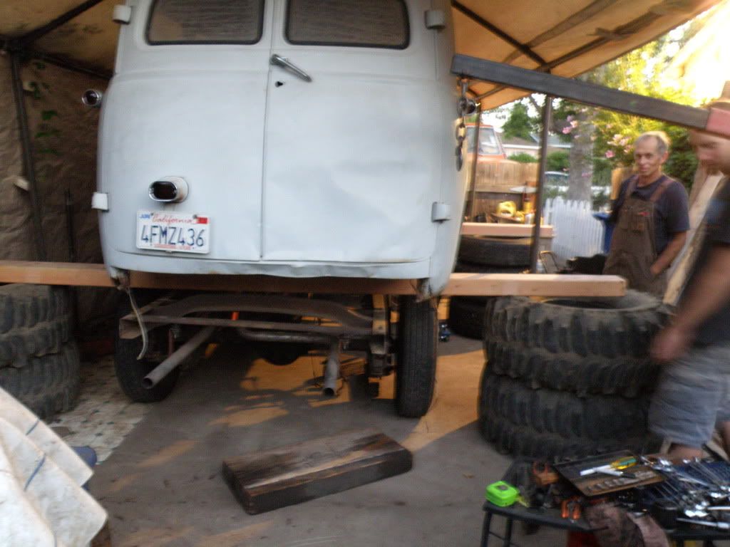

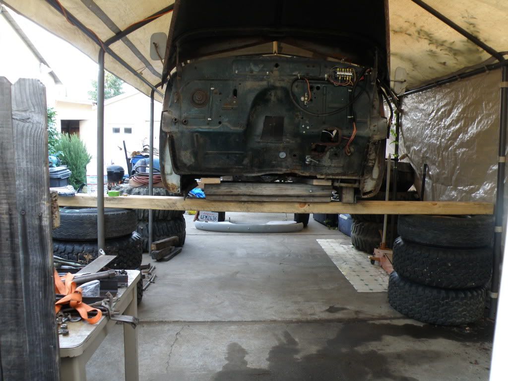

we supported the underside
lifted at the bodymounts with a floor Jack (2)4x6" and few sparetires.

we used lots of little blocks and some jackstands welded a metal 4x4 to extend jacks reach
back end
front end up
also

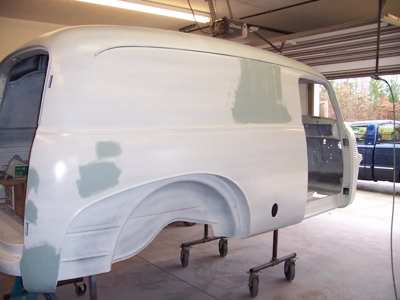

When I took the main body off my panel I had 3 or my friends come over and help me. When we picked up the body my grandson slid the home made supports under it and we set it down on them.
Its really not THAT heavy if you have all the stuff stripped off of it.

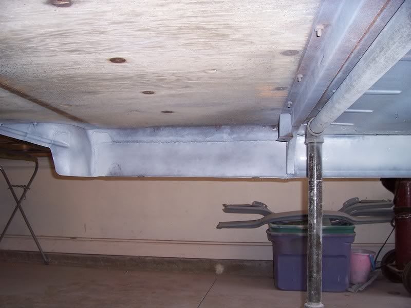

Since Lowe's will cut and thread pipe to length, free. I made my support with cheap wheels and some pipe and elbows.
http://i140.photobucket.com/albums/r19/LutherParris/52Panel/PanelBodypics027.jpg
http://i140.photobucket.com/albums/r19/LutherParris/52Panel/PanelBodypics030.jpg
