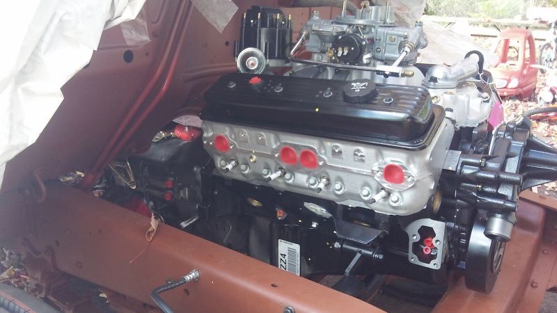

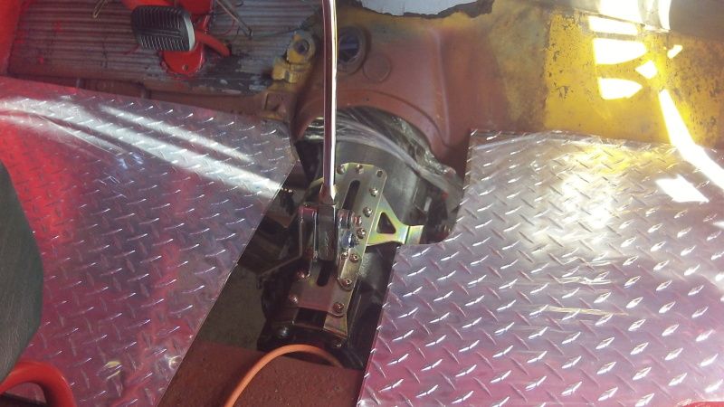

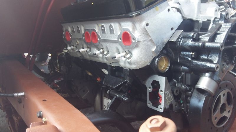

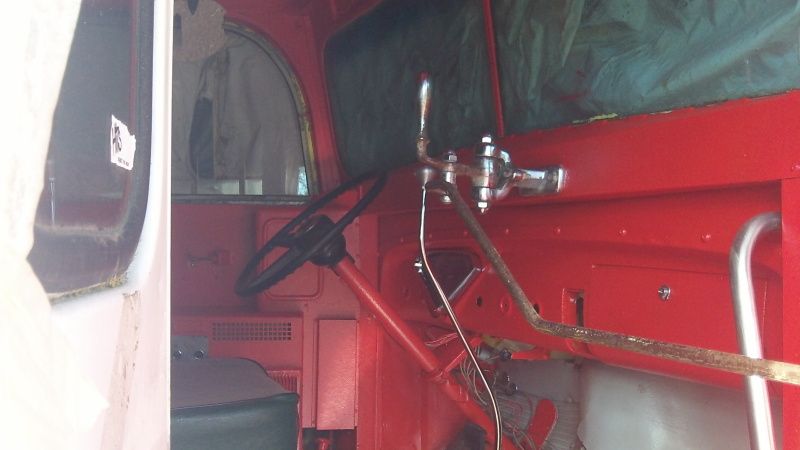

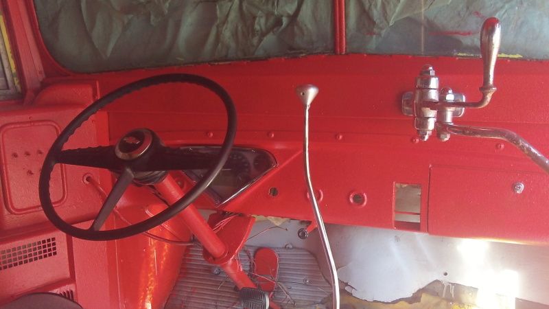

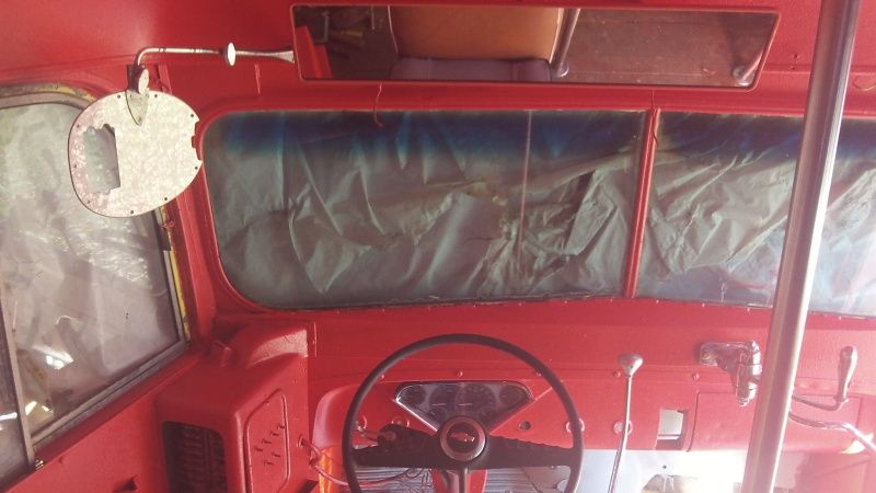

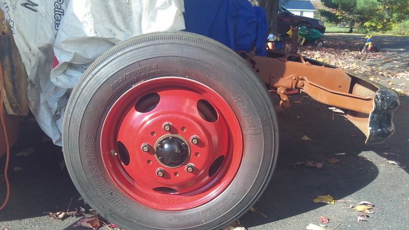

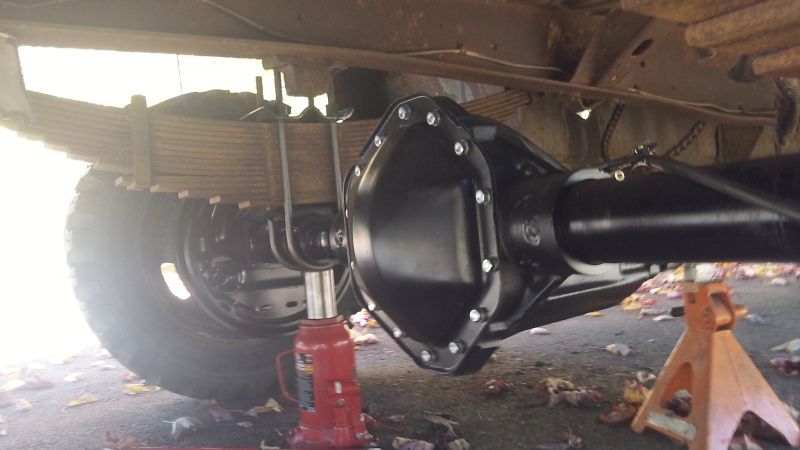

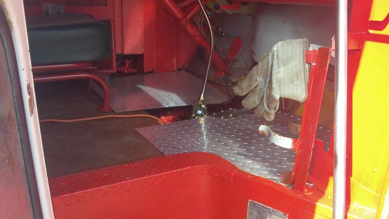

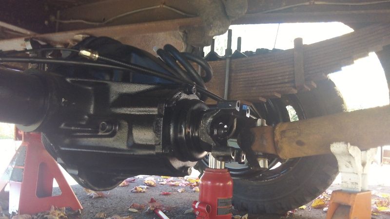

Here's where i'm at with winter closing in. New motor ZZ4,New trans TH400 stage 2,New rearend 10.5 14 bolt 4:10 gears built by Pat and Jeremy @ Custom Differential. lokar 32" double bend shifter,VHX Dakota digital dash,American auto wire update kit,New wheels and tires,Total brake job,Brakes,cylinders,lines,hydrovac,wheel bearing and races,carrier bearings,u-joints,stared red bedliner in interior.

looking pretty sweet can;t wait to see some more pics
Nice work on the bus. It also brings back some memories. When in high school I drove a bus for three years. This was in the mid 60's but we still had 55 models on the road. I've drove one like it many times.
Thanks for sharing and keep the pics coming.

That's looking very SWEET! Looking forward to more pics and can you tell me more about the rearend you're using? I plan on swapping mine next year and also putting in a TH400 trans too. Would like to know how well it rides.

The rear is a GM 10.5 14 bolt full float rear (drum brake)with a 67" WMS wheel mounting surface.The spring perches are 40" apart.8 lug x 6.25 mounting pattern.. also setup for a 1350 u joint.
