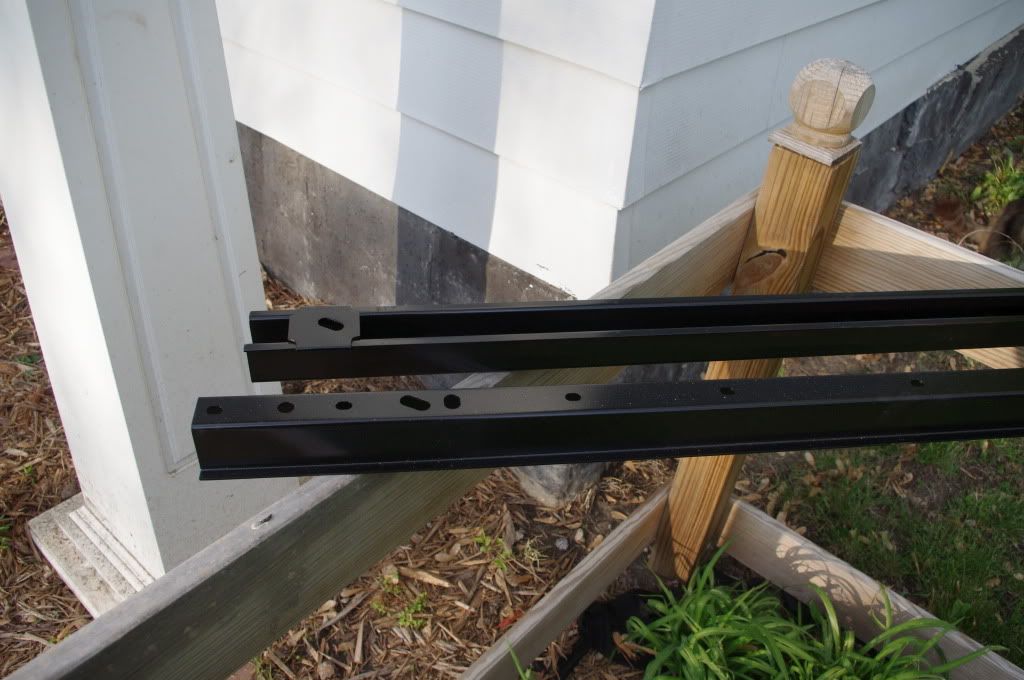

made new bed cross sills at work on the cnc plasma cutter and put the box back on my truck today. http://i891.photobucket.com/albums/ac112/Twotone_photos/My%20truck/IMGP3715.jpg
When I run out of things I can make for my truck at work I'll quit. smile
Posts: 4,983
Posts: 4,983
That looks like what I call perfection. You could do well in your own shop making stuff for trucks. They would have to fit better than Chinese.
~Jim
