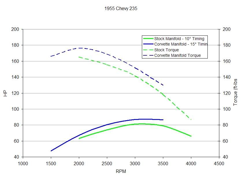

My 55.1 3100 has a 3.90 axle with 28" ties and a BW overdrive. That puts my 60 mph cruise rpm at about 2000. This is just below the torque peak for my 235. The setup is pleasant to drive.

Great advice. Thanks. I'll need to find the torque peak for my 250 and taylor the overall gearing from there. 2000-2300 RPM at 60-70 sounds like it would be right in the sweet spot.
