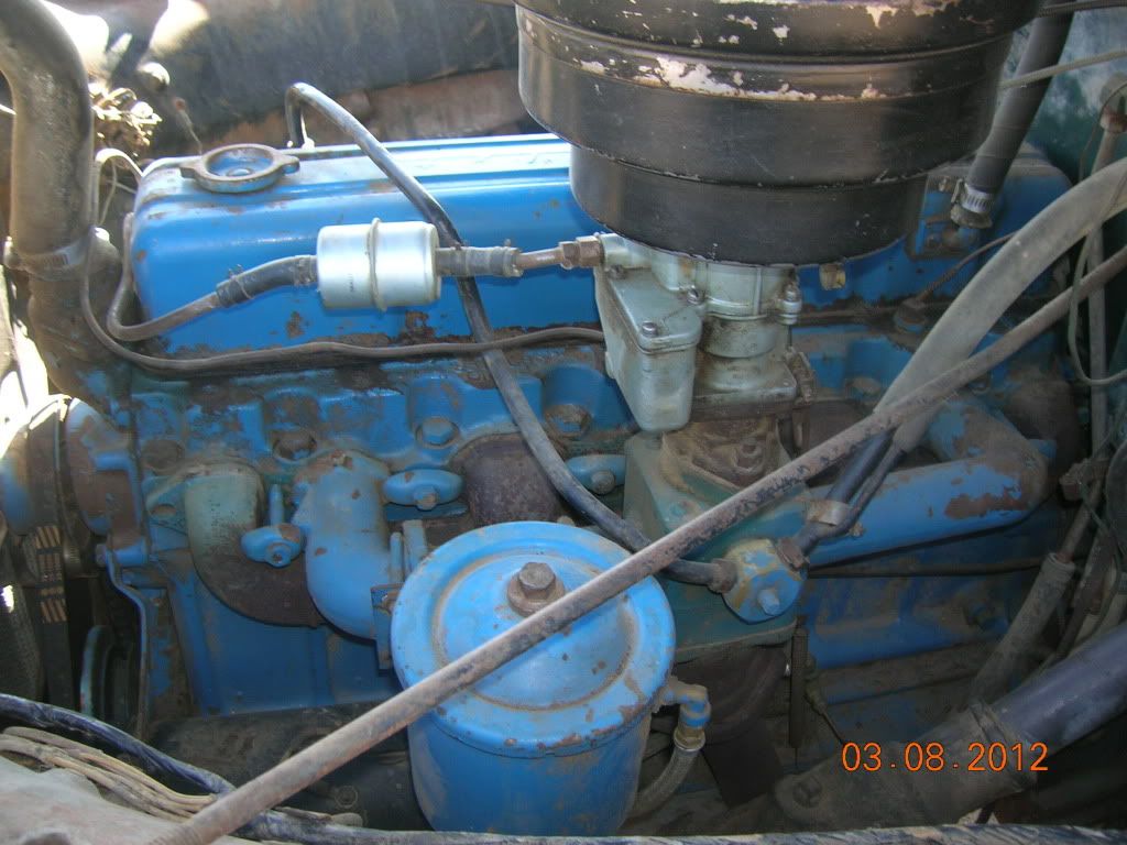

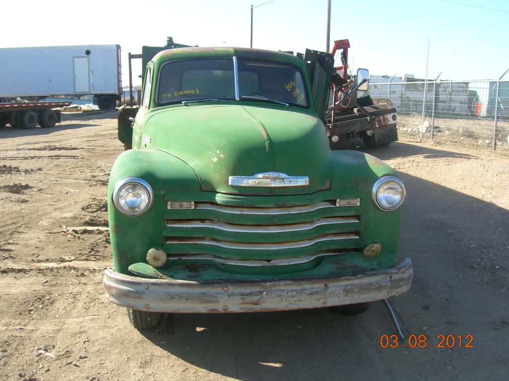

I was at the local scrap yard today looking for a 2 sp rear and found a 6400 chevy headed to the shredder. Complete truck with a old feeder box in great shape. Makes me sick! Anyway, the rear end had a raised DTA CO in a diamond shape and stamped 5800 M 429 2 Y. As near as I can tell this is the rear I need for my 53 COE because the original is a single speed. Correct? After I looked at the rear end I checked out the cab (normal wear) but noticed a key in the ignition. Pop the hood and looking back at me is a new blue wonderful engine (I almost messed myself). I climbed on board and started to get a s/n and a taped up wire arced on the starter. What pops into my head??? Battery & Key!!!! Around the front I went and into the cab, key on, choke out, pump the pedal and off she went, purring like a cat. The engine number is F54N. 261??? I hunted down the yard boss and convinced him to let part out what I want before he shreds her. They won't sell the truck because of no title. Anyway I have Friday (playing sick) and half a day Saturday to get glass, engine, rear end with all the vacuum, bumper and whatever else I can find. My only real concern is the rear, Will it work and if I know everything I need to remove. Any ideas and comments would be greatly appreciated. Thanks!
Yes, the F54N is a 1954 261 made in Flint, MI and originally installed in a 1954 6000 series (as the HD Jobmaster optional engine).

What year truck body is this (is there an ID plate, with the vehicle serial number, in the driver's door jamb)?

Tim, I'm not sure of the year the door jamb tag was all faded out and the only stamped info was 5 UWL 1192. Thanks for the help AGAIN with the motor info. I was hoping you were out there.

see if they will sell it complete minus the cab....that's the only part that needs a title. Strip out the dash, take the cab off and take the rest home with you. Faster easier and you will have everything you need plus some great extras.

I know rules are rules, but it's just a darn shame that you can't just buy the whole truck! How many guys on here would kill to find one that nice?

See if the guy will sell it to you in two pieces. Drop the drive shaft and cut the frame behind the cab. He can then sell you the front half today and sell the back half tomorrow to one of your buddy's, that way he won't get in trouble for selling a complete vehicle...just a thought.
If you pay a little more than scrap he makes out on the deal also...this truck is worth the fight!

If the fenders and cab and other sheet metal is good what's the deal there? Or did you get those already?

Well guys I hope I have made my last trip this morning to the scrap yard (for a while anyway). I have everything except the frame, body and front axle. I guess I'll trade off what I don't need. The best news is the yard owner said he had changed his mind and was going to put the body in the u-pull-it yard. Hopefully someone can use it.
