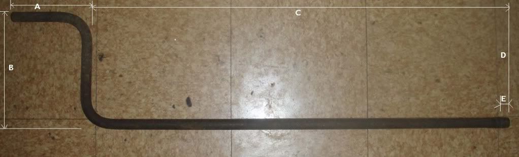

What are the dimensions of the hand crank for 1941 Chevy truck?

I got a '46 OS 1.5ton with a 216 that came with the crank.
http://i299.photobucket.com/albums/mm311/jungerfrosch/linked/1946ChevycrankDemensioncopy.jpg
A= 5 9/16"
B= 7 13/16"
C= 27 4/8"
D= added by mistake smile
E= 7/16" end to center of pin
Bar stock is 11/16" diameter
Pin is 5/16" diameter, and they stand 1/4" tall
The end of crank looks it has a forged/cast section that is added to the solid bar, or forged somehow onto the end. The pins do not go all the way through the middle of the bar, so they may be more accurately described as nubs. The hole at the end is 3/8" deep and 7/16" diameter, and on mine is not perfectly centered. It may be a result of forging the end of the rod to form the pins. if you want a close up of the end let me know.

Perfect. Thank you!!

thanks mate, i have got a crank at home that looks the same as that, was told it was for the chev but said no way it would have bigger lugs than that, good on ya
