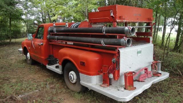

I found a 9' stepside bed recently. It's a '70 model but I think I can easily change the fenders to the older syle. Here's a link to a photo of the donor truck. http://i305.photobucket.com/albums/nn214/jfnar/57%20chevy%203800/70-1-ton-back.jpg
I didn't buy all the fire equipment in the back but I got the aluminum trim around the sides. I plan to keep as much of that as I can. I also bought the 4.10 posi rear axle. Now I've got to find some 19.5 single wheels.

Looks like a good find!
That bed mounted equipment may mean the bed has been protected and hasn't been beat up by loads.
I'd like to hear about the challenges involved in changing the fenders. I may try this approach some day too.
