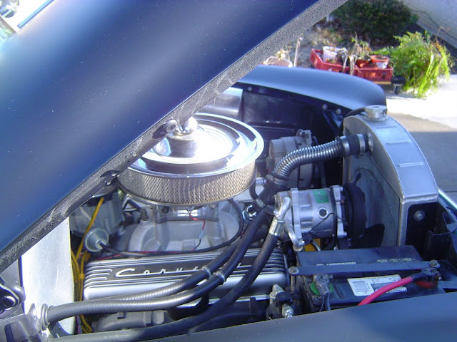

Well I installed this one this weekend and believe you me, this one works great! When you compare it to the old one there is no comparison. I had to cut out about an inch to get a good fit. It's tight in the engine bay but works quite well. I drove it around town and it keep things nice and cool.
Robert C.
I'm a Genius in the making.
1950 3600
Posts: 4,983
Posts: 4,983
looks like a winner. Good timing as it's beginning to heat up.
