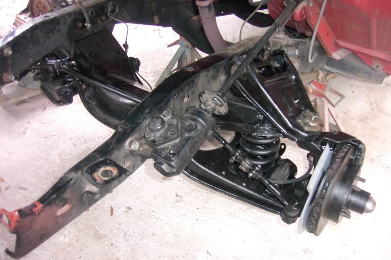

this is my 62 halfton with a crossmember out of a 71 1/2 ton...it bolted right in, however i had to drill 2 extra holes on each side of the frame. my steering box and idler hooked right up.i am less sure about the cutoff year that you can use parts from newer trucks for this swap. there is a huge thread in this forum on that subject......Mark http://i48.photobucket.com/albums/f216/applebag/Newpics025.jpg?t=1230932533

The G series vans have the wheels far apart. Take some measurements & I think you will find they will stick out of the fenders & the steering linkage is real weird. I think you will find the C series will fit better. I put a 305 with TH200 in a S10 for a friend. It turned out real good. All kinds of conversion parts are available. The only rub was the factory A/C comp. wouldn't fit.
