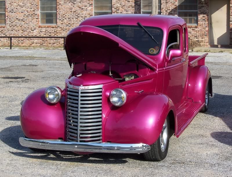

I have seen many custom trucks that have the hood welded at the hinge and open the conventional way, how is this done?
like this one
http://i11.photobucket.com/albums/a198/ahsum/1940ChevyPU.jpg

Well from that photo it looks like they added some hinge pockets to the firewall, a gas strut, and welded the side panels to the fenders. I always found the attractive part of the '40's trucks to be the side opening hoods, but whatever floats your boat. The side hoods do provide a lot of easy access, bending over the radiator gets pretty old.

If those side panels are welded to the fenders, all that might look cool until you actually have to do some work in the engine compartment.
