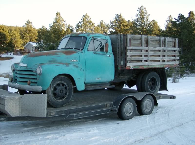

After years of building a set of Popeye arms with a come along, I finally broke down and bought a winch . It looks like it might be a pretty good one for what I need. It's a 10,000 pull and comes with a mounting plate for a receiver hitch. Power in and out, 85' of 3/8 cable. Also came with a snatch block and two differant length leads for the battery. It's from an American owned and based company but is manufactured in China, hopefully to our standards. It should hold up good enough for the amount of use it will get. Best part is it was only $300 at Sam's Club!!

I'll be putting it on this trailer for now. I'll make a mount or buy a junk trailer hitch and mount it to the trailer. This way I can take it off and store it when not needed. I'm also planning on using it for draging stuff around the yard instead of having to chain everything behind a truck to move it. Possibly make a gantry type setup also? I know there's lots better winches on the market but for what I paid and the amount it will get used, it should be fine. As far as tongue weight, I have air bags on my Suburban and with some loads hanging off the back of the trailer, it might come in handy. As far as power, I probably get a battery. I would like to figure some way to rig it up so it can be plugged into the trailer plug on the back of my truck. I'm electricaly challenged and don't even know if that's possible.

I guess I'll probably just put a battery in the storage chest on the front of the trailer. What kinda stuff do I drag around the yard??? Dead cars and trucks heading to the "parting out spot". thumbs_up

WOW! How did I ever live without a winch. I loaded my new 1954 COE in less than one minute with it. Never even groaned unlike me in the old days using a come-along.

Mine is 10,000 lb. and worked great. Still in you budget you mentioned. Comes with two different lengths of electrical cable and a snatch block. Just used it today to unload the COE, backed it off like a dream. I hate come-alongs now! grin

55 are you taxing that trailer a bit with a big bolt on it?
