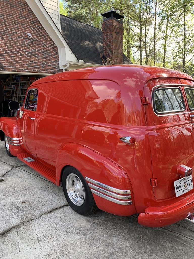

Needing new fenders and cautious about the cost and cost of shipping. Are model 1948 3105 panel fenders the same as Suburbans? Thanks

It would be ridiculous for chevy to make different ones, but who knows. I ordered all four. Very nice job on your truck.
