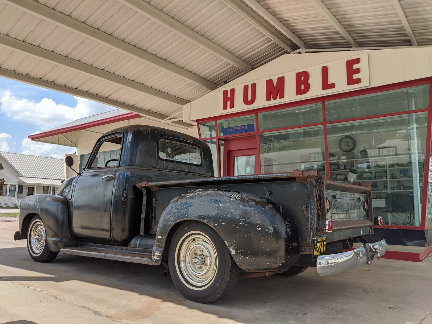

Find a pair (or three) of 1971 to ~1991 4x4 Blazer/K10 wheels. They are 6 lug, 15", with a 6" wide version (I have read 6.5") and an 8" wide version, and are made to clear the disc brakes that CPP's kit copies. They can be identified by having 4 hubcap nubs instead of 3, and do not have the bumps in between the lugnut holes. Otherwise they look the same as a 60s C10 wheel if you don't look too closely. I am running a pair of 6" wide (6.5"?) wheels on my '50 with the CPP disc kit, and have a third one mounted as a spare.
Maye this image link borrowed from another forum will work... http://67-72chevytrucks.com/vboard/attachment.php?attachmentid=1109003&stc=1&d=1368956044
are those actually indeed 15" @EchoBravoSierra ?
And they still fit?
Of course the riveted flange of the early wheels and shape of the center piece is what is causing the issue so maybe the later wheels just have a quite different back plane, so even 15 fits?
I'm measuring about 7-1/4" from hub center to the outside of caliper - the problem with the wheels I have is the inner web of the wheels - just spacing the 16's out a little bit is enough to clear them

Yessir, fifteen inch wheels. The hoop diameter isn't where the interference with the caliper is, it's at the back of the center, or the curve where it transitions to the hoop, best I can remember, at least with these particular disc brakes (based on stock 70s-80s GM components). For grins (and science) I recently had a buddy bring one of his 15" artillery wheels over to test fit. It went on fine until the lug nuts got hand-tight, then the back of the wheel center hit the caliper.

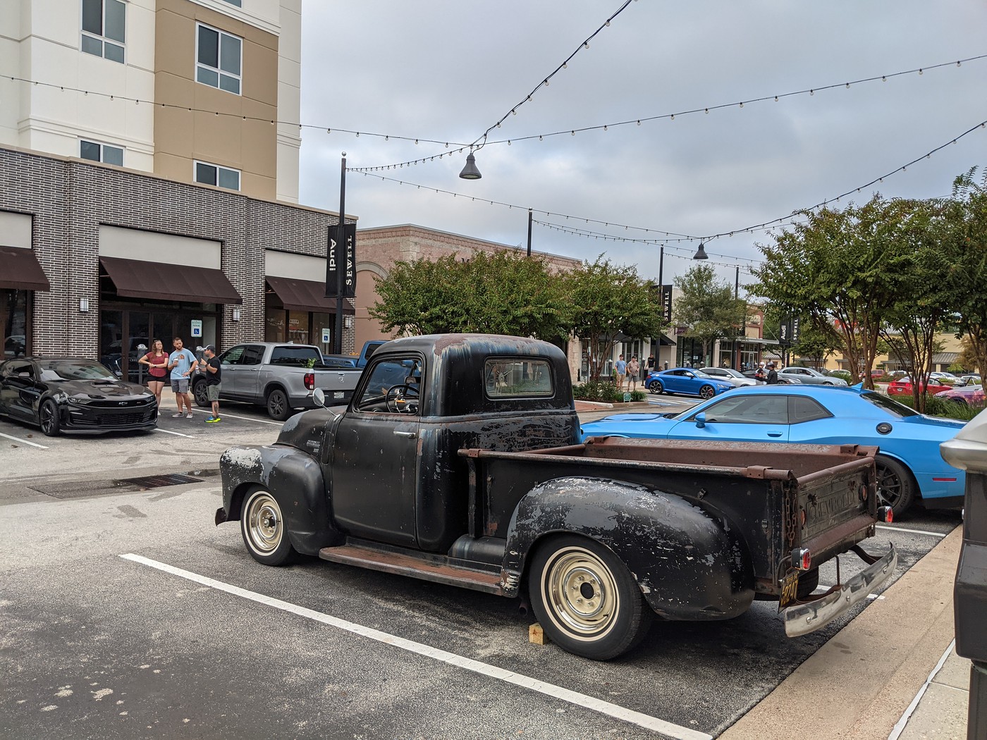

I think anything in the style that fits over the nubs would work. I think they're 10 1/4" or something like that. I haven't really shopped around for options since I had my current setup in mind.
I'm not running caps, but have spider rings that fit over the nubs just like a hubcap, in addition to trim rings, bullet caps, and lug nuts.
https://media.fotki.com/2v2aUsTpbxDubp.jpg

Yeah, my trim rings and spider rings came from Speedway, lug nuts and bullet caps came from two different eBay sellers. I was doing work on the brakes for a good portion of the summer and ended up leaving the bullets off last time I put the wheels on, and I'm currently liking the look of the front hub poking through and the hole in the rear instead of the chrome bullets.
https://media.fotki.com/2v2asgmqGxDubp.jpg
... I was doing work on the brakes for a good portion of the summer ....
Yeah, I see that strategically placed block of wood grin
I actually prefer that look personally, the bullet caps a little busy against the original 'raw' look of the truck

I like the look of your truck and those wheels work well. Those are the 4x4 blazer wheels you mentioned? I just got a 60 C10 with the stock narrow steel wheels (black) and need to get some new tires. I am thinking of going with different wheels in an attempt to fill up the front fender a little more but I am not sure if this is a good idea on a number of levels (wider footprint harder to steer with no power steering, rubbing or other fitment issues, etc). I don't want to lower the truck at all. I like the idea of using other stock chevy wheels or at least wheels with good compatibility.
I did find another set (4) locally (well if you call 5 hr round trip local) and delighted to prove you right.
Slipped one over the hub and fits like a glove.
The wheels I got are a bit rough, so will need a bit of work, but that's all more fun.
At least I can get decent rubber on there
Thanks for your great advice!
