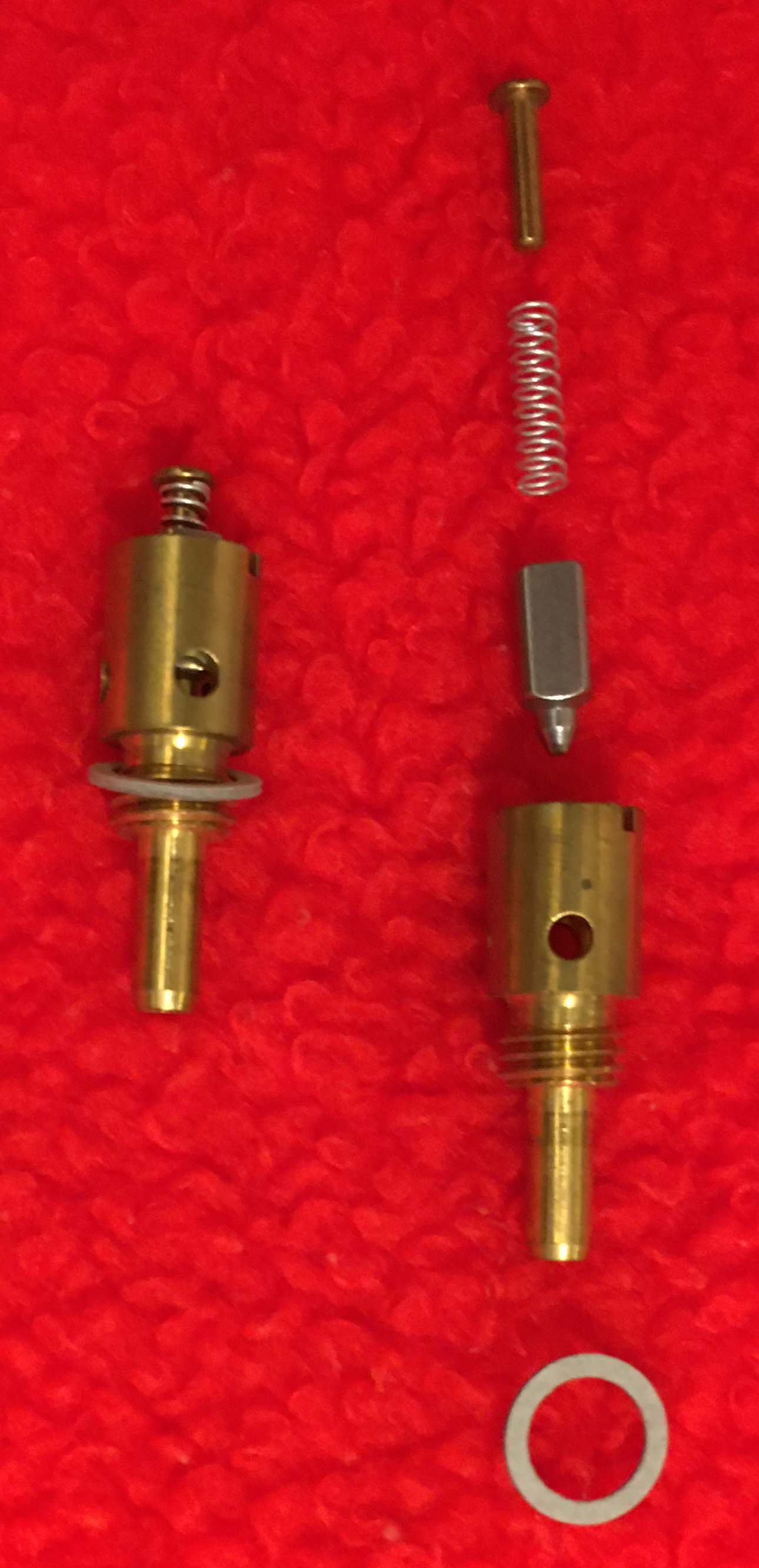

Finally got both the check weight and the pump check ball freed up. A combination of picking with very fine tools and light tapping with a hammer from the back side made the difference.
1) Most likely going to re-use the all metal needle that was in the carb along with the existing seat. They look in good shape. I just bought a cheap kit for gaskets and pump, and I will do some measuring, but sounds like it’s highly unlikely they provide the correct needle and/or seat. Will upgrade to a Carbking kit if we can prove this is a functioning unit.
2) I didn’t have time to study closely, but it looks to me like the metering rod might not be perfectly straight. If so, should I try to carefully straighten it...or am I likely to make it worse? (Or perhaps it’s not supposed to be perfectly straight). Might have been my imagination.
Had to do a bit more cleanup on some hardware last night, but I think she’s pretty much ready to slap back together. If and when I can find a few minutes. Kids’ baseball/softball schedule is gonna start kicking my butt soon.

Pine-Sol is an interesting choice! And leaves it smelling like a high school locker room, too, I'll bet. If you are concerned enough about the loss of coating to want to paint the outside (outside only), here's what I did on one YF which had been dropped and suffered a crack (which I had to silver solder to repair): First I masked and painted with Rustoleum Champagne Mist. Left masked and let that dry for a couple of days and then overcoated with VHT Clear Satin. The Champagne Mist color is ok on a carburetor. It doesn't have the iridescent appearance the original plating did, but no spray I've seen does. Some claim to, but in my opinion they just look like an odd mistake in combining gold and green paint that won't mix together well---sort of like Rainbow Brite got sick and threw up. There will be some complex instructions on the VHT can about how you have to treat that stuff at varying and specific temperatures. I didn't do that. I was mainly looking for something clear that wouldn't be affected by gasoline.
Ok, about the metering rod...I'd try to straighten it as best as I could. Lay it on your kitchen counter top where the round end and flattened part hang free over the side and roll it lightly with your fingertips to check. When you have it as close as you can get it, you'll feel it rolls straight. and that should be good enough...unless it is bent where it fits into the jet. That is a different conversation, but usually those get bent in the middle. You can also polish it and the jet with a bit of old t-shirt fabric and some MAAS, Flitz or Semi-Chrome polish. You also ought to remove and check your idle jet. Some call it the low speed jet. If you had a bunch of crud in parts of the carburetor, it could be in other passages too. I use either a piece of small copper wire or a piece of music wire and air or spray cleaner. The old needle/seat ought to be fine and will be better than anything that came in the cheap kit.
~ Jon

Good tip on the paint. Do you have a pic of how that turned out?
I’m not really worried about how it looks, but almost all of the original coating is long gone and I’d like a little bit of protection for the bare casting.
I had thought about polishing brass bits, chickened out thinking that if removing even a wee bit of material on a critical internal might affect running.
Both the idle “tube” and the main jet the rod fits into were removed for cleaning in this process.
Side note: Definitely a lot more going on design-wise in the YF than the B. A more sophisticated machine. Really anxious to see how those differences translate on a running engine.

I’ll start with the easy-to-type questions. The others relate to pump and metering rod adjustments.
1) Use a gasket under the needle seat? I don’t remember one being there when I took carb apart.
2) I’m re-using the “original” needle and seat because neither included in the kit is even close to correct (more on that later). The needle tends not to fall freely when you turn the bowl cover right side up. It’s all in good shape. No burrs or rough spots or anything.

(1) The needle seat uses a gasket
(2) The correct needle and seat from the bottom should be: gasket, seat, needle, spring, "golf tee".

1) Good.
2) I got it right!

If one is rebuilding a Carter YF designed for either the 216 or the 235, the valves in the picture below are correct.
Two valves are pictured; one assembled, the other unassembled.
[img]https://www.thecarburetorshop.com/Carter_fuel_valve_spring.jpg[/img]
Jon.
I’ll be darned. The needle, spring, and golf tee match that exactly. However my seat does NOT have the extended pipe on the end. What is that for?

Quote "(3) I guess they just provide a crapload of seat gaskets?" End quote
Some 40 years ago, we started adding gaskets of different thicknesses on OLDER carburetors with cast brass float arms. The cast brass arm can normally be bent ONCE; the second bend generally results in a "two piece arm".
Possibly Walker, or others have picked up on this.
Not necessary with this float.
