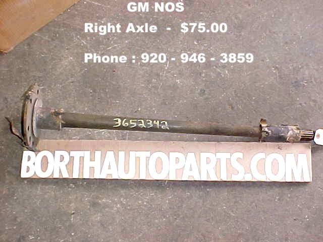

1946 1/2 ton axles .
LEFT SIDE - GM # 3652341 - 28 & 3/4 " O.L . - stamped 3652341
RIGHT SIDE - GM # 3652342 - 29 & 3/4 " O.L . - stamped 3652342
TRY
Dan's GM Obsolete
Chinook , Montana
phone : 406 - 357 - 2615
At one time , Dan's had both axles GM NOS .
At one time Borth Auto Parts in Oostburg , Wisconsin had both axles GM NOS for your truck @ $75.00 each
PICS
https://i.postimg.cc/sDR73pkq/1940-46-Chevy-Comm-Axle-Shaft-No-3652342-RH-NOS-75-00-2-In-St.jpg
https://i.postimg.cc/wMDNhvmw/1940-46-Chevy-Comm-3-4-Ton-Axle-Shaft-No-3652341-LH-NOS-75-00.jpg
George
