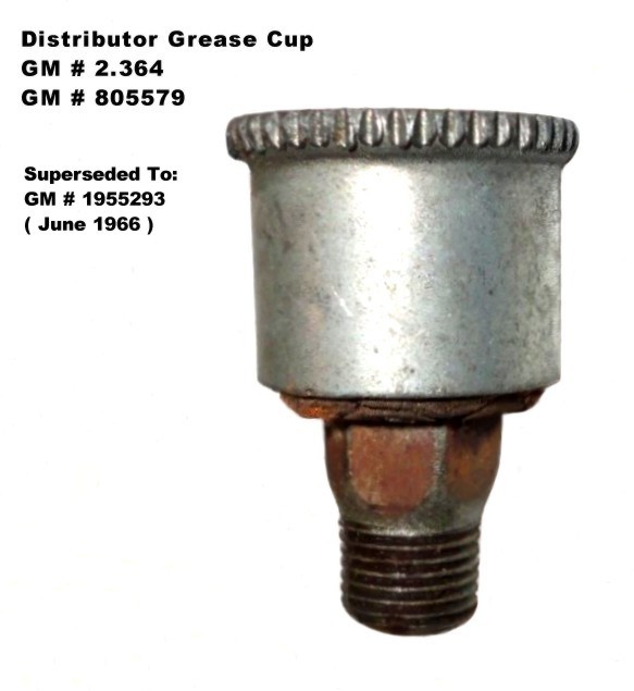

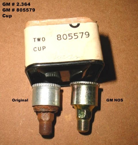

Kevin ,
If you need a new GM NOS grease cup & fitting
( 4 ) are currently available GM NOS on ebay .
Go to ebay & type in the search box...........805579 .
The GM grease cups hardly ever show up on ebay .
I consider them a rare part & very hard to find .
Here's the cup & fitting that's on ebay .
$25.00 & Free shipping .
Anyone that needs a nice new rust free Cup & Fitting.........here's your chance !
PIC
https://i.postimg.cc/Bb41ghjp/grease1.jpg
Here's a GM # 805579 that I purchased years ago .
PIC
https://i.postimg.cc/8PThBCWG/805579-Dist-CUP-GM-NOS-3.jpg
https://i.postimg.cc/PfQDxk7R/GM-805579-Cup-and-Fitting.jpg
https://i.postimg.cc/7YP2JW8Y/Distributor-Grease-Cup-GM-805579.jpg
https://i.postimg.cc/NfP59Gkp/Grease-Cup-1955293-GM-NOS-Old-GM-number-805579.jpg

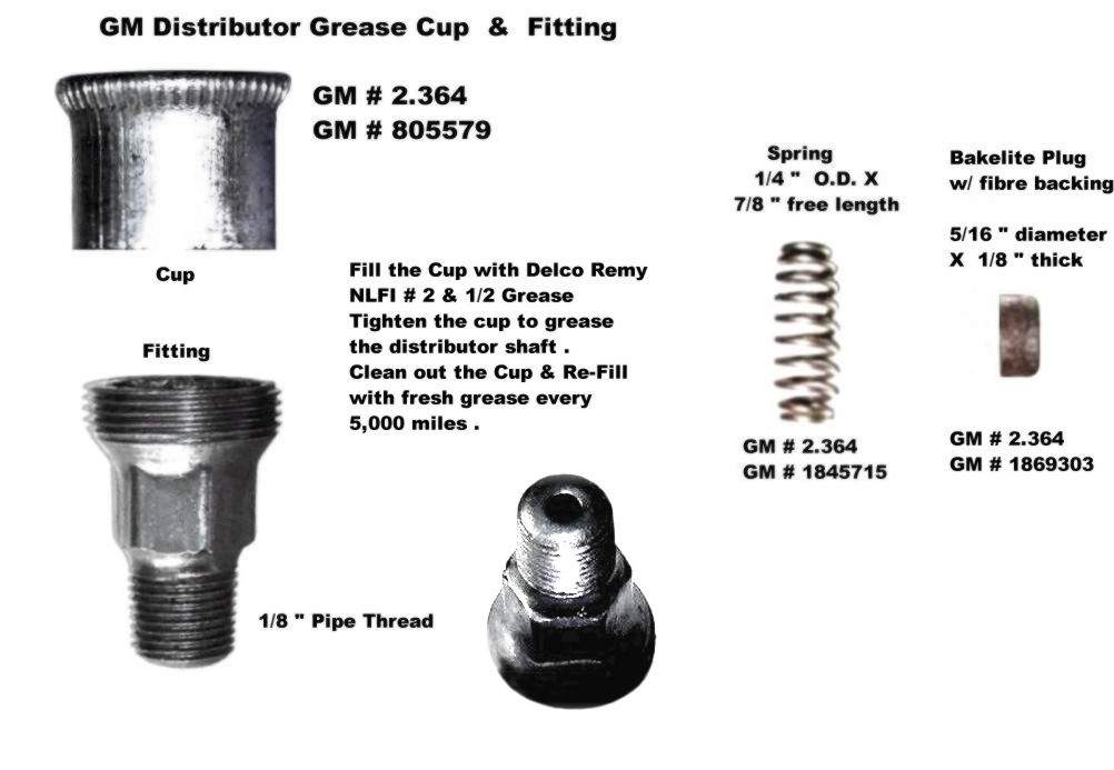

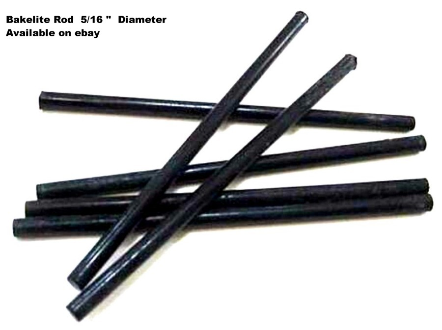

I see some 5/16 " diameter BAKELITE rods on ebay .
PIC
https://i.postimg.cc/fLVFBK0G/Bakelite-Rod.jpg
I wonder if the bakelite rods on ebay could be modified to be a replacement plug
since the GM plugs are no longer available ?
The original PLUG had a FIBRE backing with a total thickness of 1/8 "
so, the actual thickness of the bakelite was pretty thin .
The plug was like a sandwich glued together .

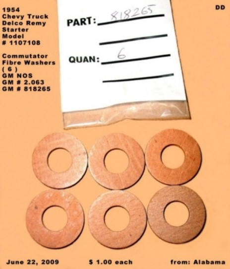

I have some GM fibre starter washers .
PIC
https://i.postimg.cc/htYHk6bC/Commutator-Fibre-Washers-GM-NOS.jpg
I'd like to come up with an original type plug using a bakelite rod on ebay
and some FIBRE from one of these washers to create a copy of the
original GM sandwich...........any suggestions ?
What kind of glue would one use ?
I'd like for someone to come up with a workable spring replacement .
The original seems to be a pretty strong spring .
Dragsix , Do you know the GM part # of the spacer / cushion ?

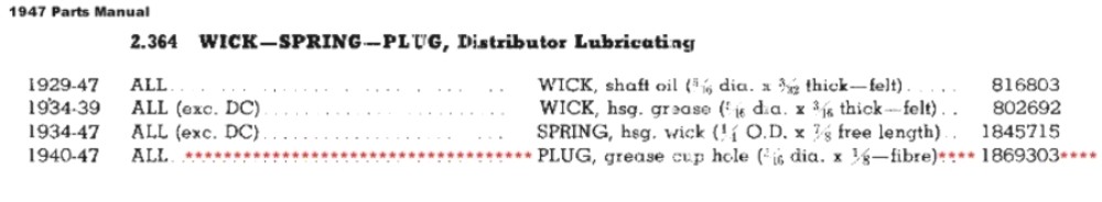

Here is an illustration of parts.
It looks like it was/is a felt "wick"?
The diameter and thickness of the felt wick changed in later years.
Does anyone have GM documentation stating the composition/material of the 216/235/261 felt wick?

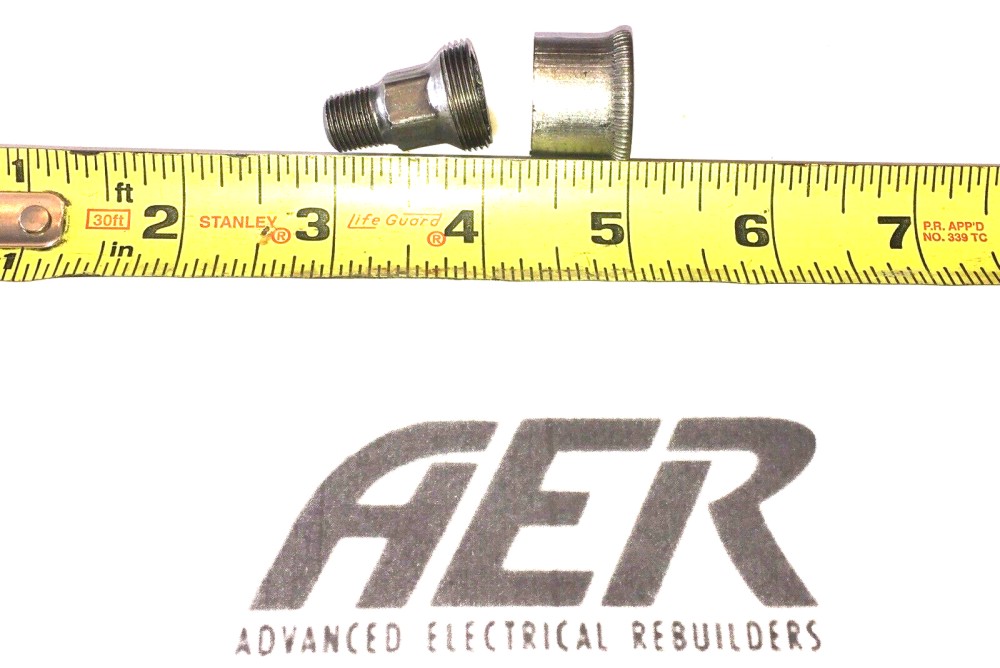

Carl,
Look at this info on turning & refilling the CUP ..
I have ( 2 ) nos GM Cups # 805579
They do not have a leather seal .
Is this leather seal a myth or someone's add on idea ?
I'd like to know the GM part # for this leather cup seal .

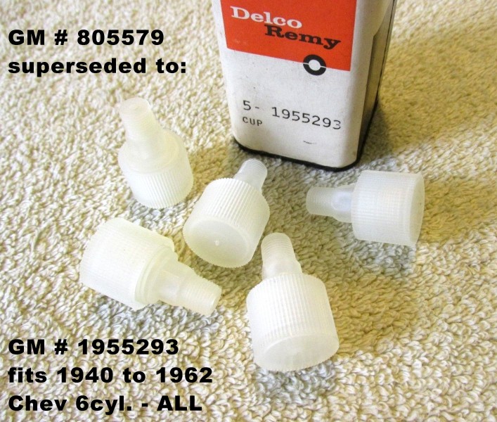

Its hard to see, but if you look at the photo I posted of the parts, look at the stem where the threads are for the cap and you will see a ring of threads that look darker then the other threads on the stem. Its actually a little piece of leather, a ring of leather (with threads from the cap in the leather) that acts like a seal for the cap. The later metal replacement stems don't have that little ring of leather.
As for the little disc, its not actually a plug. Grease needs to be able to get around it so it is actually small then the id of the stem port. Its entirely possible that the disc was a piece of bakelite with a piece of fiber bonded to the bakelite. I have never seen a nos disc so by the time I get a distributor apart, its either worn to the nub or missing entirely. Like I said, I used a piece of delrin rod and had a friend chuck it up on a lathe had machine a few down to the same diameter of a worn out disc. The finished piece is on the right in the photo. Also, later NOS 2403 distributors came from Delco Remy with plastic stems and cups, and those same plastic cups and stems were sold over the counter. The plastic parts also did not have the little ring of leather.
Below is an nos 2403 replacement distributor with the plastic stem and cap. It’s discolored but you can see no leather ring. The replacement plastic caps and stems are also below, same deal, no leather seal.
They seem to be referring to the entire assembly as a "wick" in one of your attachments. The bakelite part itself is referred to as "plug 2.363" in the parts diagram which you posted.
Felt would last about 7 revolutions in that application.
Carl
I am thinking poorly tonight, Carl - my house water pump stopped working.
Which link shows 2.363 as your describe?
I see 2.363 in the later parts book - distributor mounting, not the grease cup parts?
http://chevy.oldcarmanualproject.com/1929_57chevyparts/57cmpc0221.htm
Posts: 10,301
Renaissance Man
Renaissance Man
Posts: 10,301
It is on the first of your three attachments. The one with pictures.
I see 2.363 in my third attachment - the 1929-1957 Parts Catalog Page:
2.363 BUSHING GASKET CLAMP, Distributor Mounting for 1955 and later 8 cylinder engines?
2.363 is not even shown in earlier Master Parts Catalog/Books (no 8 cylinder engines)?
As usual, Carl, I think I am in my own twilight zone on this topic. headscratch
I find it helps when I talk/mumble to myself a lot.
Also, I think this thread at-first was referring to the "make-up" of the "cup" that has the screw-on metal "cap".
I am referring to the spring and the tip that push against the distributor shaft. In particular, the makeup/composition of the "tip".

My GM parts catalog goes to 59. If that little bakelite disc is listed I cant find it.
Mike
Thanks, Mike
If someone who has such a disc, it would be nice to GM documentation listing such a disc.
Here's are two guesses:
- maybe the disc is listed in later Master Parts Manuals?
- maybe such a disc was used in later distributors, and, it fits in the older distributors?
Joined: Dec 2017
Posts: 1,652
Joined: Dec 2017
Posts: 1,652
As for a nos cup with the leather seal, this guy still has one or two NOS for sale. Look up Item No. 253388488715
Mike

Can-you/will-you take a photo/scan of that page, and post it here?
Joined: Jul 2007
Posts: 444
' Offline
Joined: Jul 2007
Posts: 444
1947 Parts Manual
Group 2.364 - Part # 1869303
PIC
https://i.postimg.cc/02QsrG14/1947-Parts-Manual.jpg
1869303 Grease Cup Plug
G.
