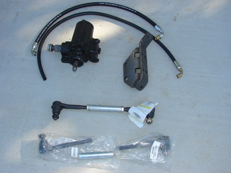

I bought the CPP kit.....pretty much a bolt in install
CPP kit

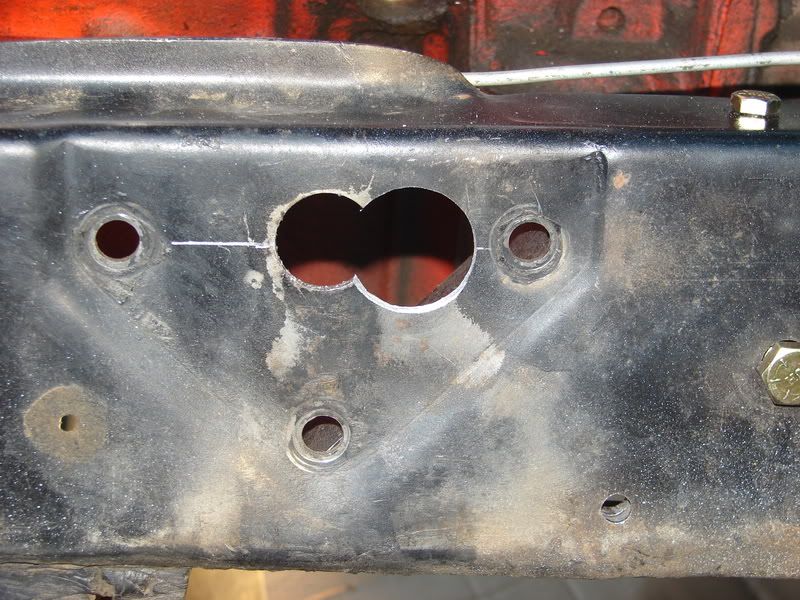

Had to use a hole saw on the frame and drill a couple of holes, EZ install... Frame mod... new hole on right.

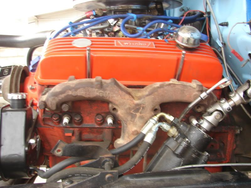

HOWEVER...I had to make some changes....my beloved headers had to go, replaced by stock rams horn manifolds....and the stock steering column had to go, replaced by an Ididit column. PS installed
I liked the look of the brushed metal column so painted both the u-joints and column with clear spray paint. I should have done this years ago, got rid of all the steering slop.

The one mrduck shows is the Toyota kit. It mounts inside the frame. You can modify the stock column or use an aftermarket column. I enlarged the original hole in the frame for my conversion. I prefer ABS in Orange to CPP.

84-87 4x4 pickup. I used a standard GM pump (late 60's-mid 80's) with V-8 brackets. You will need to reduce the pressure on the GM pump to match the Toyota. 1300psi vs 900. If you have a 6 cylinder, there are guys on this site that have the brackets for sale. You will still need a mounting bracket for the box, a modified pitman arm, and a drag link. It is also recommend that you upgrade your tie rod. There are no standard lines for this application. You will have to have them made or obtain them from an aftermarket supplier. The folks that sell these kits have snapped up most of the boxes for rebuild/resale and no one makes them new - yet.
