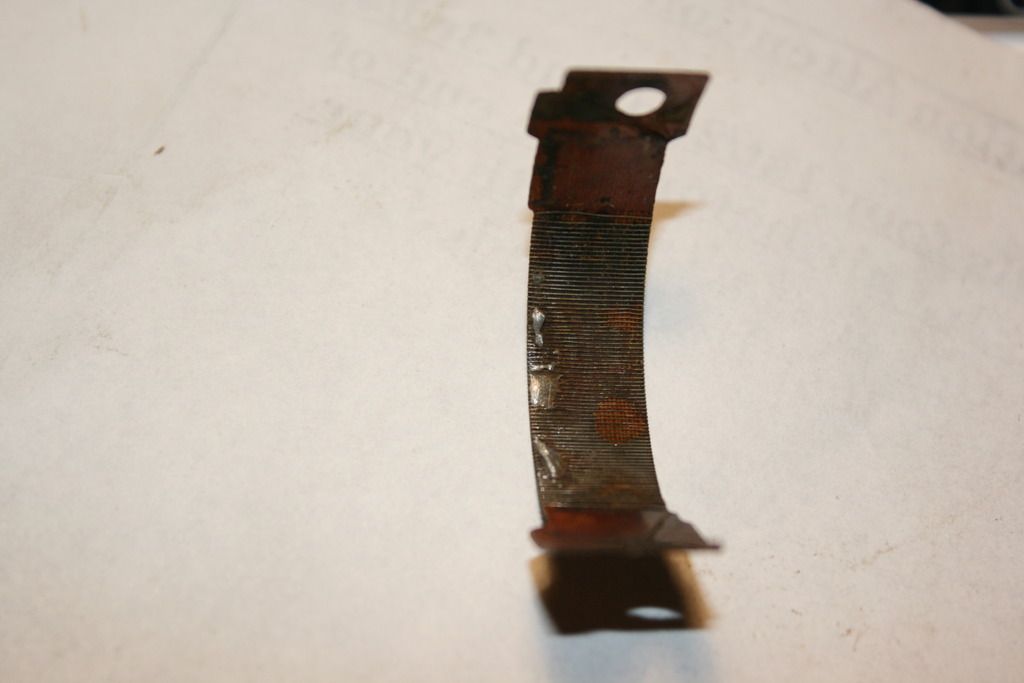

I am certain Jerry knows more about the 4100, but in the 3100 full is 30 ohm and 0 is empty. Or at least it is that way on the 1952 model. You can check the fuel level with an ohmmeter if the prior owner didn't burn out the sender with his 12v conversion. If he connected 12v to it, it could have been fried and that means you'll get no ohm reading (open circuit). If so, you might want to remove the sender and see what is happening there. I will tell you rebuilding the original sender isn't easy. I've tried it and the problem is the shaft is steel and the housing is some sort of potmetal which over time wears out to the point the wiper flops around and only makes occasional contact. If you need a replacement sender, there's a guy on eBay selling a decent 30 ohm sender. But as I posted a month or so ago, some of the senders sold by some of the suppliers are junk. The makers (whoever they are) use 90 ohm senders and drop blobs of solder on the windings to reduce the ohm rating. You can see this here:
http://i1154.photobucket.com/albums/p535/JonGoodman/IMG_8579_1.jpg
This was bought from a well-known supplier of old truck parts and it never worked right. I'm sure you can see why.
Jon

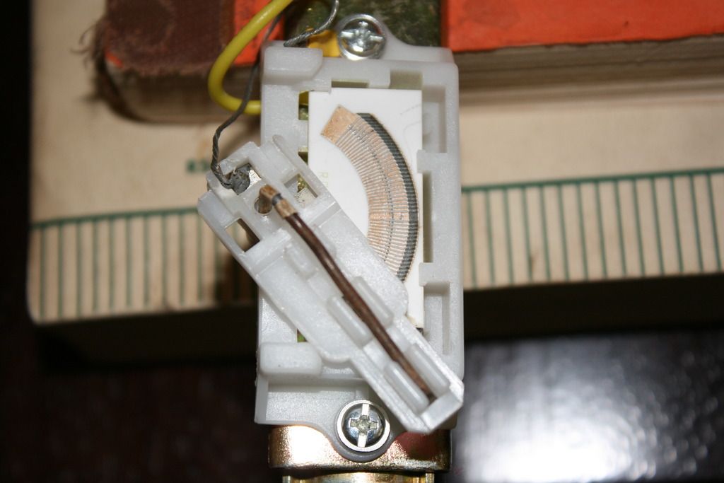

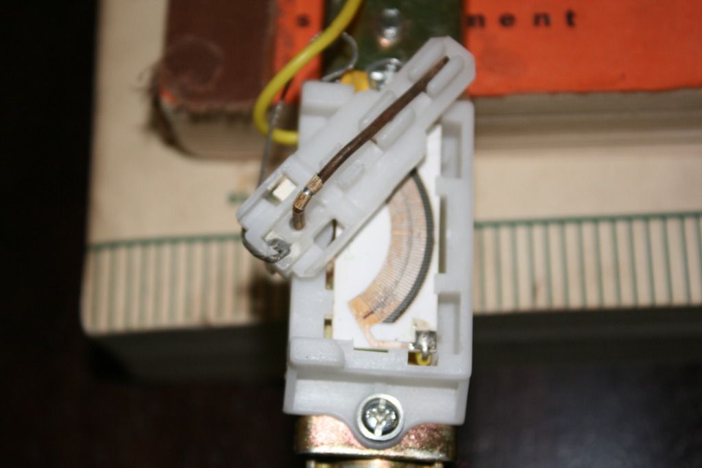

Logic sometimes seems to send me off on the wrong track. I had to sit and think about this whole thing a few weeks/month or so ago myself. And even then I wasn't completely positive until I hooked everything up to see how that gauge read. So that we'll have them here, I've taken 4 images and I'll leave them on my photobucket thing. This is the best of all senders I've found because (a) it works by wiping a vertical plane. Most of them as you know work by wiping a curved surface. To me vertical is better. (b) as you'll see it is accurate to 30 ohm. Most of the ones I've seen might read somewhere between 28 and 45 ohm. (c) it wasn't expensive and (d) the moving parts are nylon so they ought to last. It is the sort of sender I think a detail-conscious guy like you would appreciate.
Here is the sender in full position:
http://i1154.photobucket.com/albums/p535/JonGoodman/In%20full%20mode.jpg

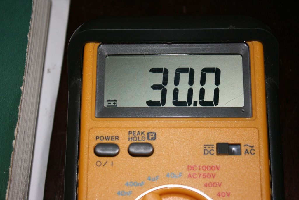

Here is the ohm reading in full position:
http://i1154.photobucket.com/albums/p535/JonGoodman/Full%20ohm%20read.jpg

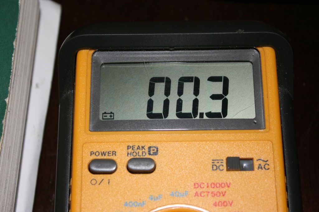

Here is the sender in empty position:
http://i1154.photobucket.com/albums/p535/JonGoodman/In%20empty%20mode.jpg
And here is the ohm reading in empty position:
http://i1154.photobucket.com/albums/p535/JonGoodman/Empty%20ohm%20read.jpg
Now having said all this, the tank in my truck is baffled horizontally what looks to be about 2 inches from the bottom. This is a new tank made in Canada and it seems like they did a good job. I didn't notice if the old tank was baffled this same way, but it had developed a rust hole which meant it wasn't going to be used any longer. Net effect obviously is that when the gauge says empty, there will still be a gallon or two of gas in here. Not a problem, but a fact. The sender in empty mode can't fall to the bottom of the tank.
