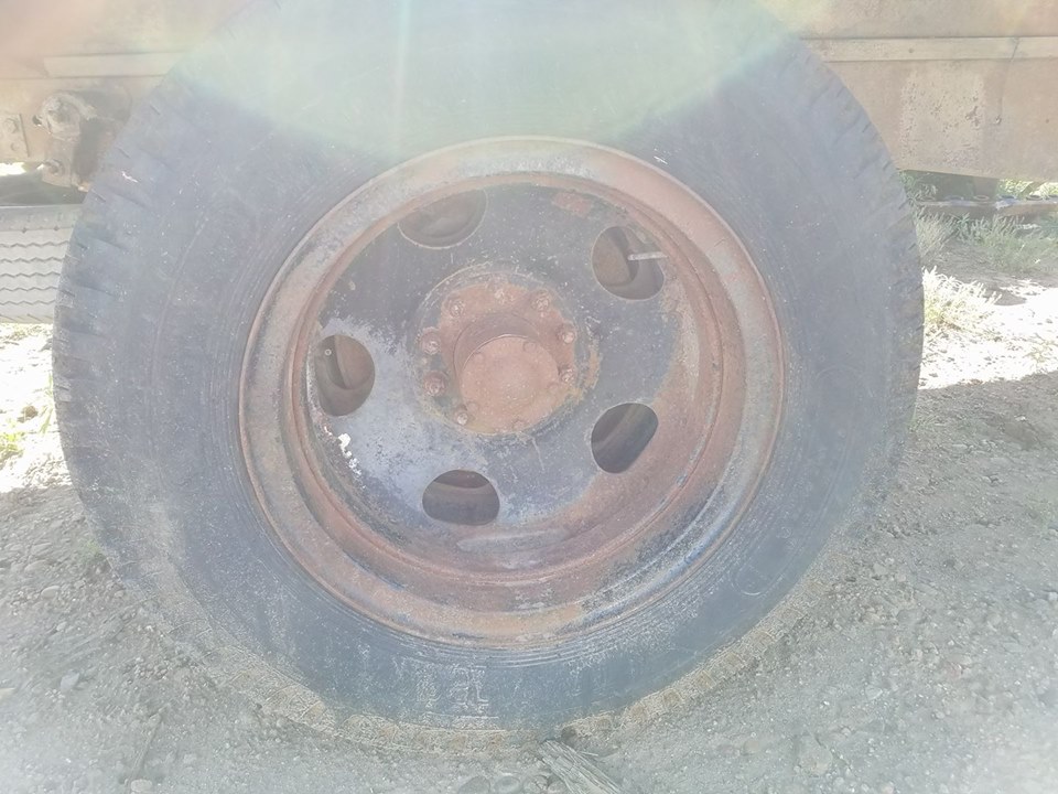

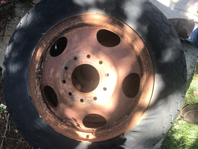

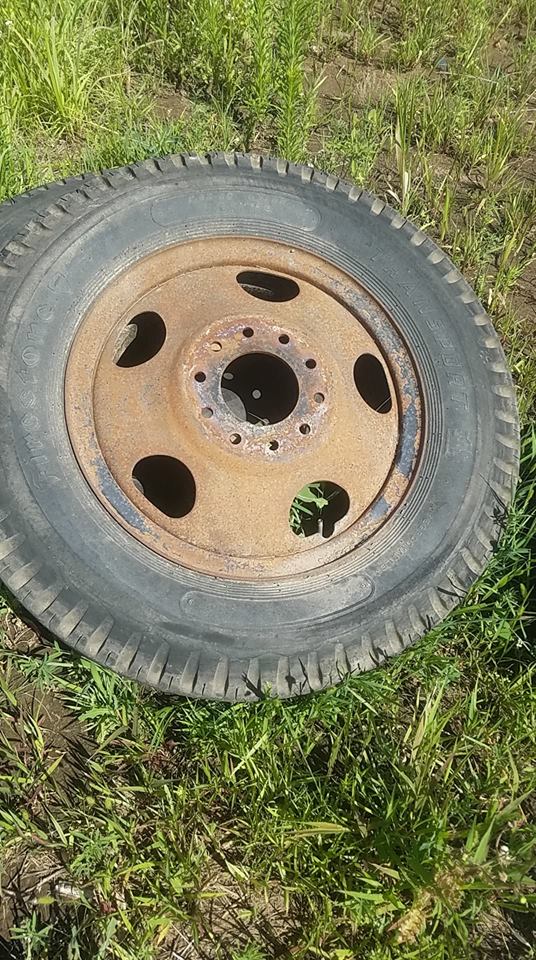

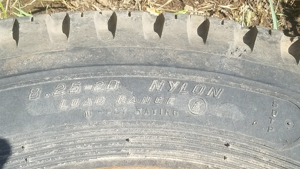

Looking to purchase from the 53 I was able to grab some new photos and have added. They do seem a bit different.
[img]http://www.atlantamafia.com/33614532_1704273716354292_648777560502566912_n.jpg[/img]
[img]http://www.atlantamafia.com/36248051_1743932859055044_6583299263986401280_n.jpg[/img]
[img]http://www.atlantamafia.com/36231248_1743931855721811_2569420754122702848_n.jpg[/img]
[img]http://www.atlantamafia.com/36256833_1743930285721968_4702153680541974528_n.jpg[/img]

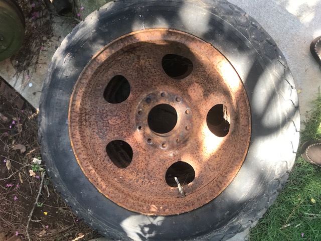

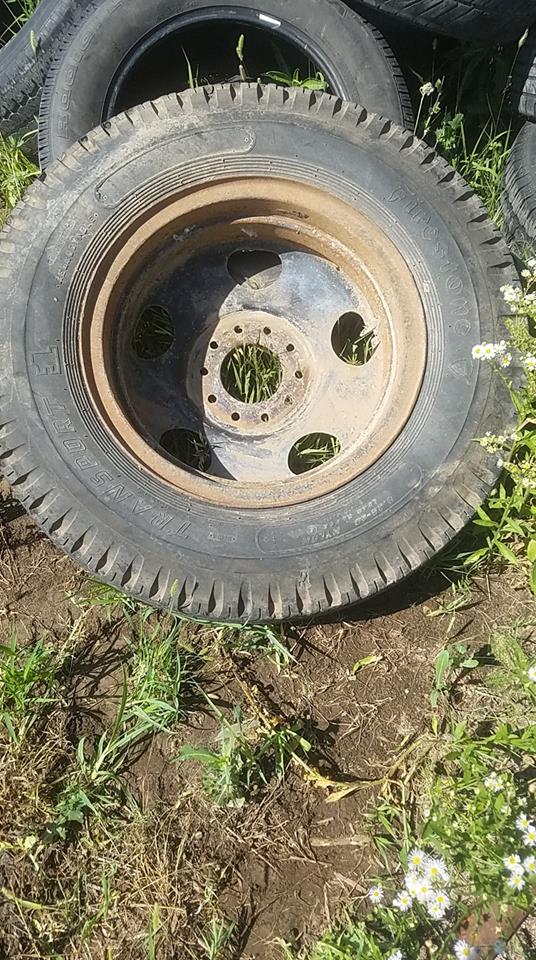

My wheels from the 40
[img]http://www.atlantamafia.com/MyWheels1.jpg[/img]
[img]http://www.atlantamafia.com/MyWheels2.jpg[/img]

The first four pictures are the " Bad one" . I would suggest to keep on looking.
J. F.
Posts: 8,878
Posts: 8,878
You don't want the wheels pictured, they are the RH5 design.

Thank you for the replies. I will steer clear.

I am good grabbing the ones if Have in the second photo. Those are hard to find. I will look for the 22.5 as well. Not much of anything left. I found those in Kansas. Fastenal provided a quote of $225 from Kansas to Georgia. Anyway, I will keep looking.

The quick way to identify the RH5's is the 2" wide flat band where the wheel barrel meets the center, and the lack of a split on either bead ring. Those are the "widowmakers" that can fly apart during inflation it there's even a slight amount of wear/rust at the lip where the two wheel halves lock together.
