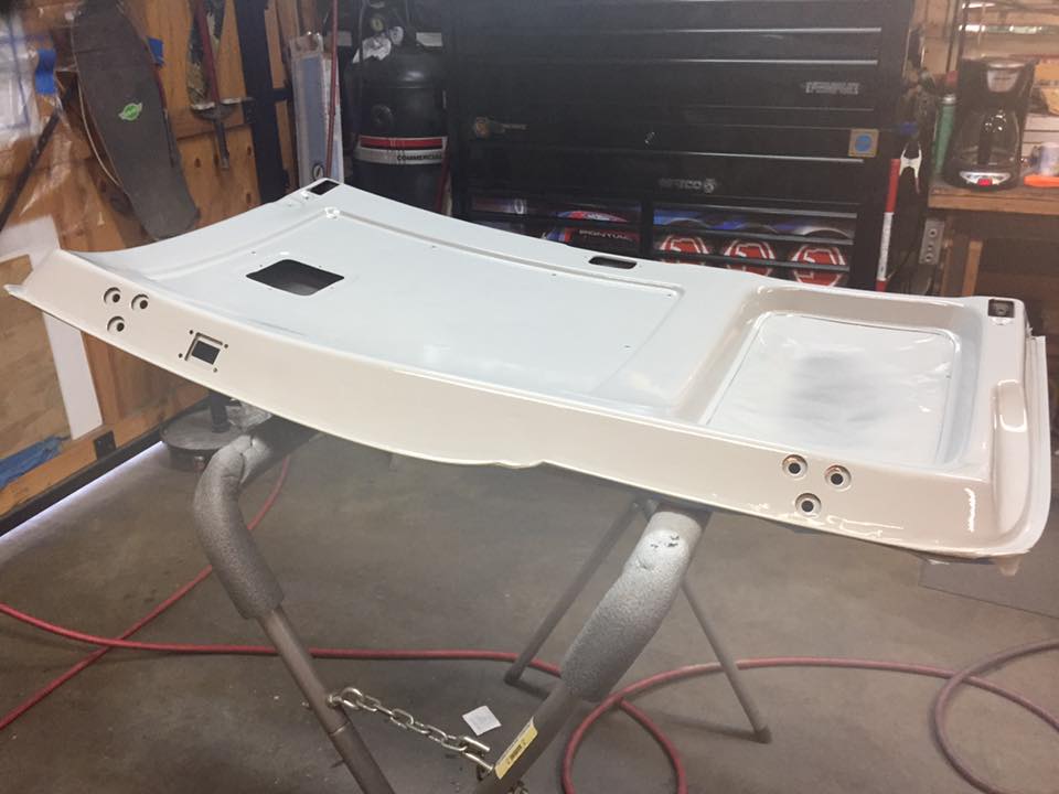

Interesting. On your pic labeled 267 was your door already set up like that or did you square out the hole and drill the mounting screw holes?
~ Phillip
Posts: 4,252
Posts: 4,252
That's the way my door came.
Between 1947-1954 there were two styles/methods for getting tail light wires from the body to/through a panel-body door.
1. A metal contact plate
2. A metal spring-like conduit through which the wires were run (my 1954, for example).

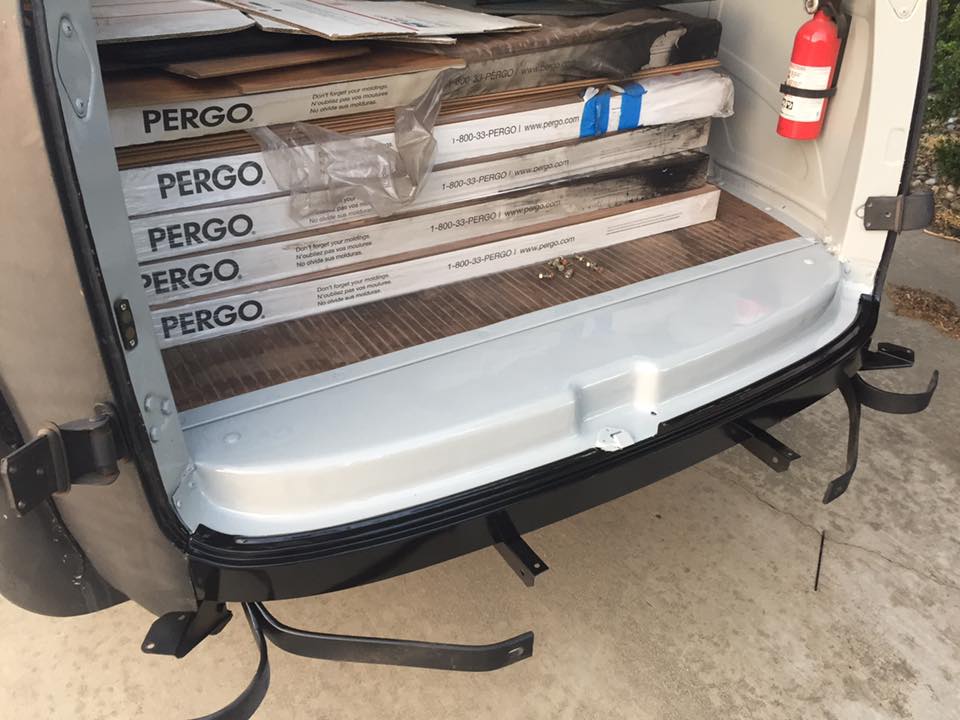

Marks pictures are all of correct factory cutouts.
door jam
You might be able to look or feel through the stop light access hole on the barn door for the cut out for the switch.
switch on door jam
1952 up had the conduit from door jam to barn door.
Conduit loom

Neither of my 1951 doors have indentations. The buttons are flush mount on the drivers door. The optional contacts with corresponding light are non-existent on my passenger door.

Ok so it appears that during the body work of my 'Burb we used later year doors than what came with it. We actually used 4 barns to make 2 good ones.
Since my body had the correct indentation for the contact style switch, but the door had the hole for the plunger style I went ahead and took a cut off wheel and cut the door to accept the contact style plunger switch. Took about 2 hours to get it right but its good to go now.
