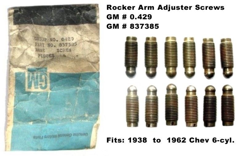

Did you check the other ( 11 ) adjuster screws ?
Sometimes it doesn't pay to try to save a few bucks on a rebuild .........just my opinion .
Genuine GM NOS Rocker Arm Adjuster Screws
photo@photobucket
http://i669.photobucket.com/albums/...hrod%20Adjuster%20Screws_zpsxxbzirj2.jpg
I know these are being re-produced for cheap . I've also read the re-pro's DON'T fit like
the original GM rocker screws .
Get yourself some REAL GM adjuster screws.
Dan's GM Obsolete
Chinook, Montana
phone: 406 - 357 -2615
Dan's has ( 9 ) GM NOS GM # 837385

Thanks guys. I called Dan's Obsolete and they had a couple screws in stock and I grabbed both of them. Thanks for the info '54 3600. I pulled the #5 intake lifter and the #6 intake lifter and looked inside bores with a Snap On snake camera, everything looks OK. Lifters look fine also. I'll have my mechanic friend look also for a professional opinion. I'm leaving for vacation in a few days so I'll let you know when things get done and what happened. Thanks again for your help.

OK, back from the Alaska cruise. Now back to serious business. My mechanic buddy came over, checked the lifters and cam lobes on #5 and 6 and gave the seal of approval. We replaced rocker screw on intake #5 and checked all others. #5 was only bad one. I buttoned everything back up, hit the starter pedal and she fired right up. Purrs like a Singer sewing machine. Thanks guys for your input and thanks for the info on Dan's Obsolete.
