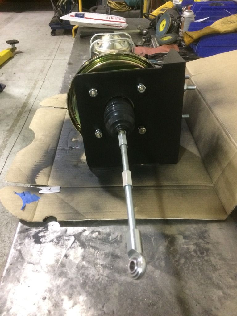

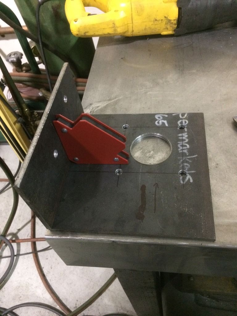

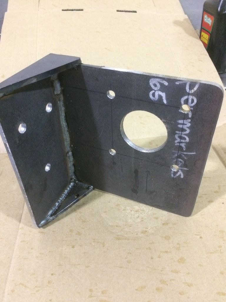

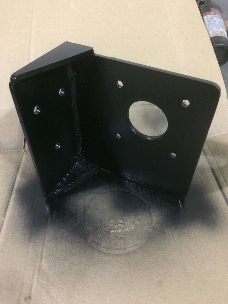

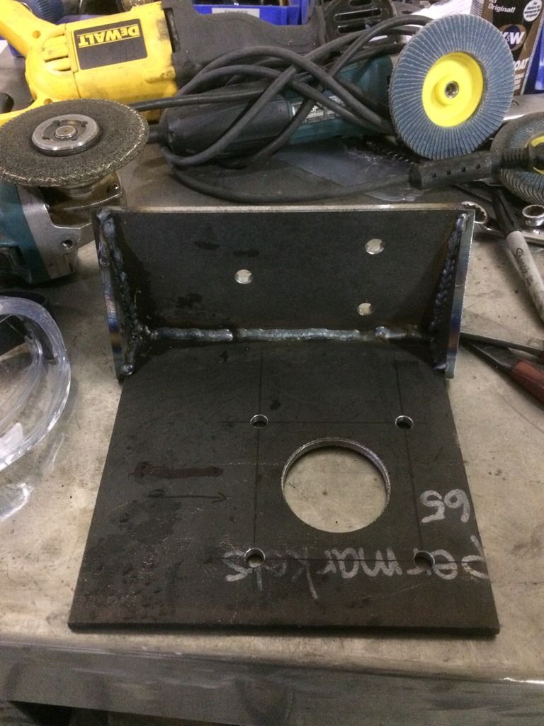

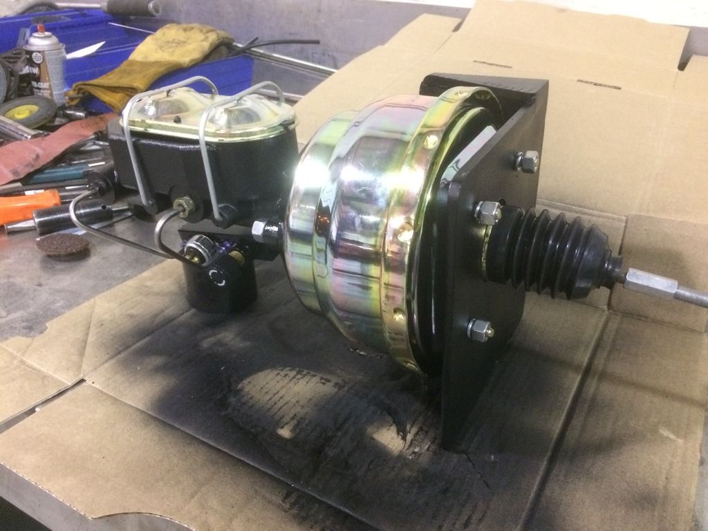

My thoughts exactly. So today, all of my replacement parts will be delivered and I can start getting back on track. The main part for this thread is the booster and MC. I hope to have the bracket finished this Saturday. Just need to drill 4 holes in it, weld it with the correct alignment and then bolt in permanently to mount the booster. Then get the motor reassembled and running before I can test the brakes out.

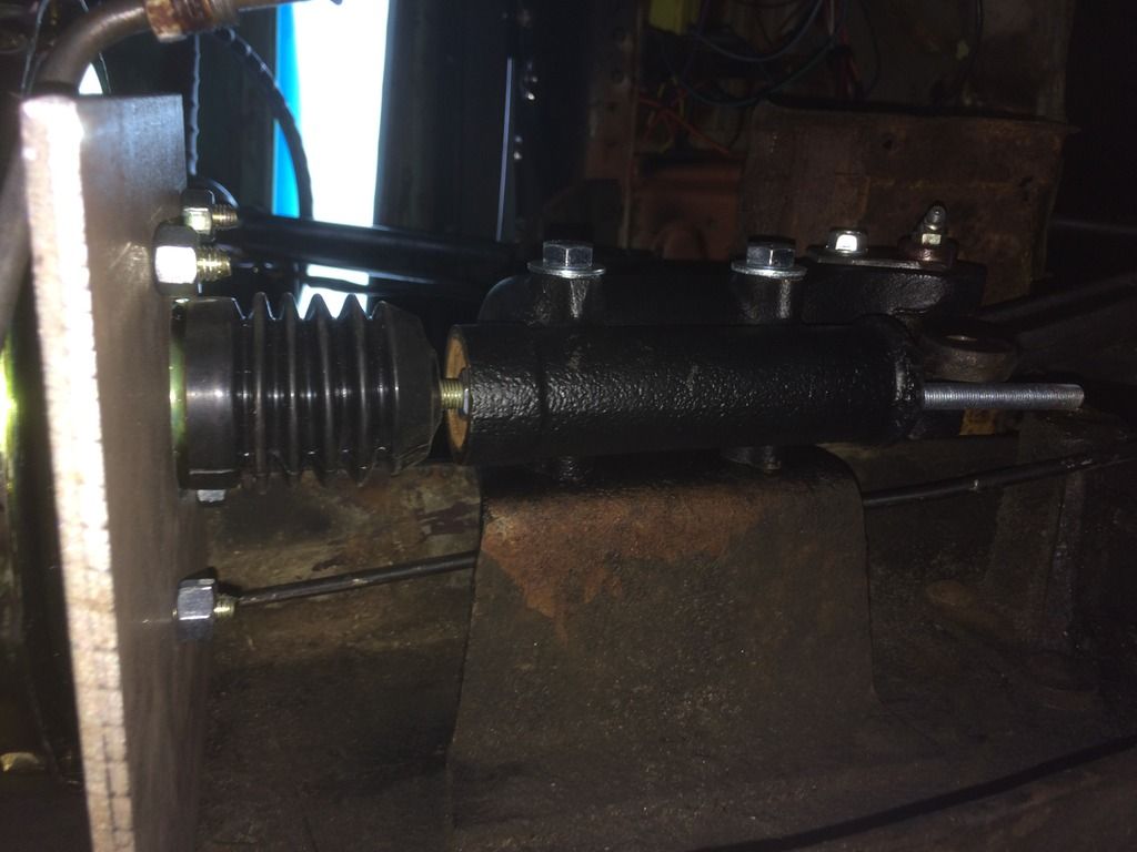

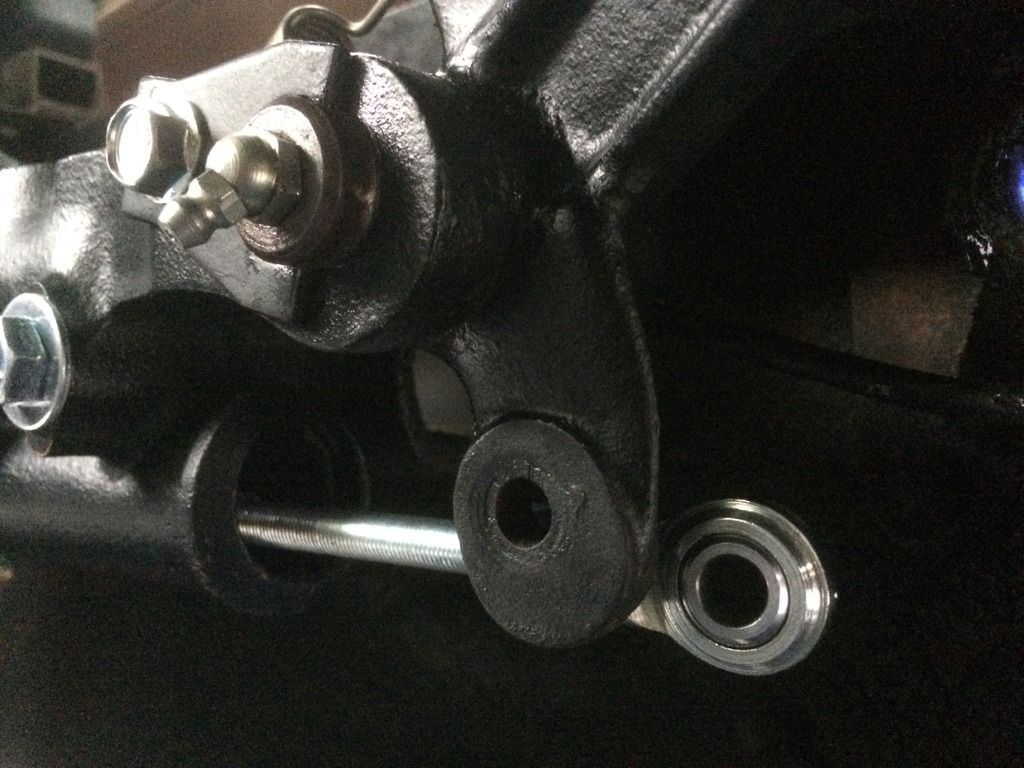

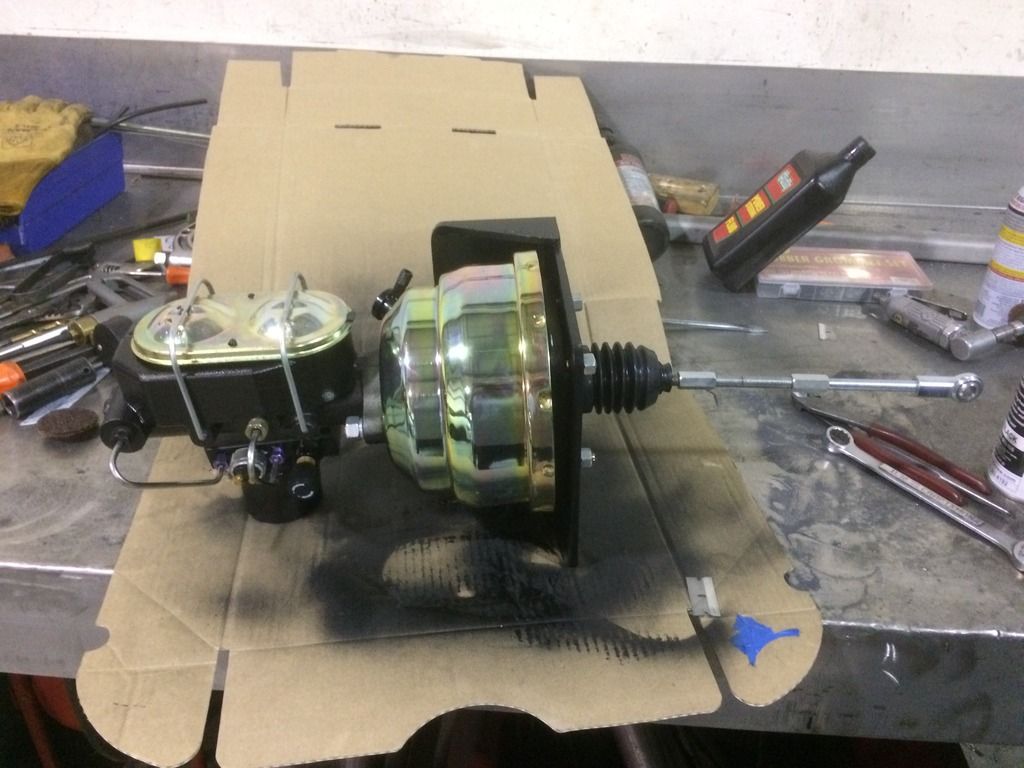

I got the push rod sized and installed to check for proper fit and operation. Here's a short clip showing it in action. It's being painted and will be installed tomorrow. I still need to get my engine back from the machine shop so I can assemble and get back into the bus. Then I can get it running again and test the new brakes.

I installed the motor and transmission last weekend. The Transmission cross member sits right where I had my booster bracket. Sooo, I am moving it back a few inches tonight. Once it's mounted I can make a new pushrod and get the brake lines done and bleed them. Driveline gets to the driveline shop tomorrow after I measure it up tonight and then installed when back. Then it should be go baby go time. smile Here's a link to my other thread with the motor install and running.

Everything is pretty much done. Brakes are all in and bled. Just need to install the drivelines and hookup a few wires, vacuum line to the brake booster and install the gas pedal. Then take it for a ride. Here's to hoping the brakes work as I planned them to. Well, I hope EVERYTHING works as I plan it to. I want to make it easy to drive and have fun!! smile
