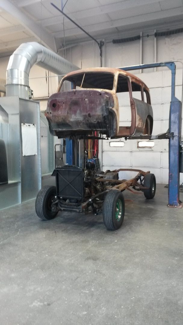

I was lucky enough to have a friend offer his lift.
body lifted
