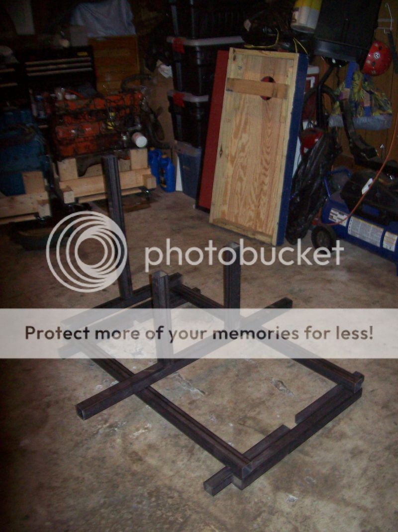

The last 2 days have been spent cutting up and cleaning steel pieces for the engine run stand I'm building. I'm using some scrap metal that a good friend gave me as well as some new steel. I want to start welding some of the pieces tomorrow.
This is what the completed run stand will look like.
Some of the pieces mocked up.
Scrap sheet metal that I removed from the bed 4 years ago now has a new purpose.
A friend gave me pieces of scrap metal that I cut up into these pieces.

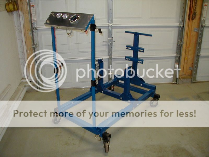

Not much to report on the truck but I did make progress on my engine run stand. My recently purchased 230ci is on the run stand now. The engine looks great bit I did find a few failed exhaust valve seals. Once the engine has been resealed I'll put it into the truck. Hopefully by February. HERE is a photo.

Looks good Lug, does that stand feel sufficiently sturdy when you push the engine around on it?

Yes, the engine run stand feels very sturdy. The large wheels are a MUST. I have more work to do on the stand to get gauges hooked up and a place for a ground to the battery. Need to paint it too.

Major step forward last night. I'm done fabricating my engine run stand. I was able to do a short test run of the 230ci that's on the stand and things look good. Here's a video link.
Next step is to change the exhaust valve seals since several have gone bad. Then change any leaking seals and paint. Then install in the truck by end of February.

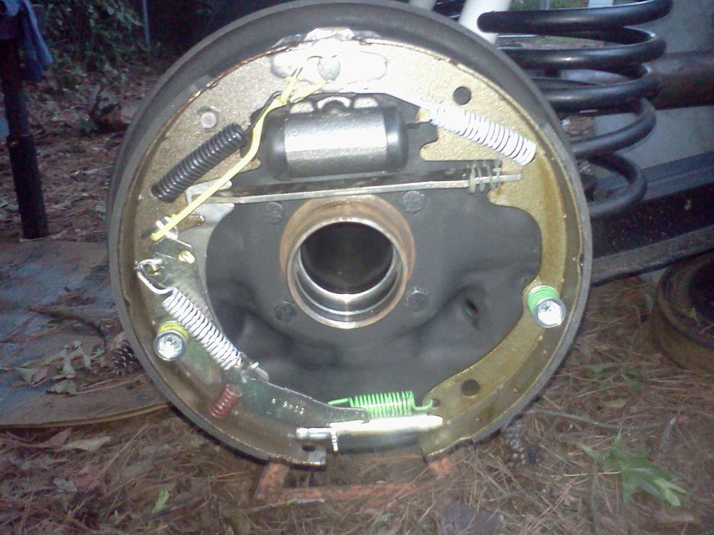

Tonight was step one in the rebuild. I was able to hammer out the dents and twists in my radiator support. It really hurt to see some of my absolutely pristine original 1965 parts get damaged. That radiator support looked like it had rolled off the factory line when I was done with it a year ago. Doesn't look quite so good now but it will pass my standards. I'm building a truck, not a Ferrari. See my BLOG 3/28/16 post for a few pics.
