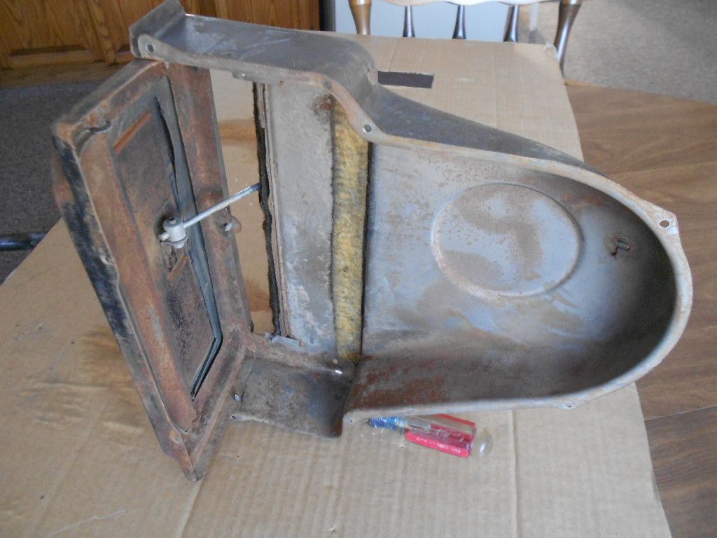

I have a '50 3100 with a EA Deluxe Heater w/ defroster does anyone have any histroy on these? are they dealer installed or added later by someone else I haven't be able to find much information on these only one mention of one I found searching here.

Here is a piture of mine all the ones I had seen were different than this. Mine is square with a door on the front that exposes the core. It has EA Deluxe written vertically on the front
https://www.dropbox.com/s/vtrp4sotdf0c3gg/IMG_4457.JPG?dl=0

"E. A. Laboratories Inc - Makers of Aircraft, Automotive and Marine Appliances"
early aftermarket supplier of car & cycle accessories
They made a lot of horns (mechanical and electrical horns) in the teens and twenties.

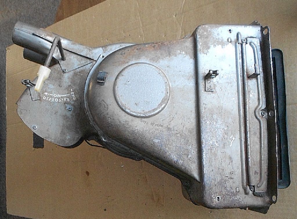

What is this Heater it is from the 1951 Chevy Accessories Installation Manual it does not look like the round recirculating type.
It has more of a square box. Is this the same Heater
The article states it is a 1947-48 GM recirculator heater.
Recirculating type looks like the 1st two pictures in this THREAD.
It has more of a rounded box with a round heater core.
I thought General Motors offered from 47-55 1st series truck
A rounded box recirculating type heater with a round heater core.
And a fresh air/air flow HEATER semi-round box with a rectangular heater core.

So to summarize, from 1947-55 there were 4 Accessory truck heaters that were offered by the GM dealers.
(1) Recirculating box type, Years ?
(2) Recirculating round type 1947-55 1st series
(3) Air flow 1947-52 (no doors)
(4) Air Flow 1953-55 1st series (with doors)
(5) ? Drawing only, Mr.Oddity Years ?
Just had a brain wave, would the COVER from the Air Flow heater with doors fit on the Air Flow heater without doors.
If it did fit, you would be able to use two cables.
One cable to operate Defrost/Floor damper.
One cable to operate Fresh Air/Recirculating doors.
You would kinda have a hybrid heater.
The cable support bracket on the left would have to share both cables.
And you would have to find room next to the existing under dash Cable Knob (54 dash shown)
