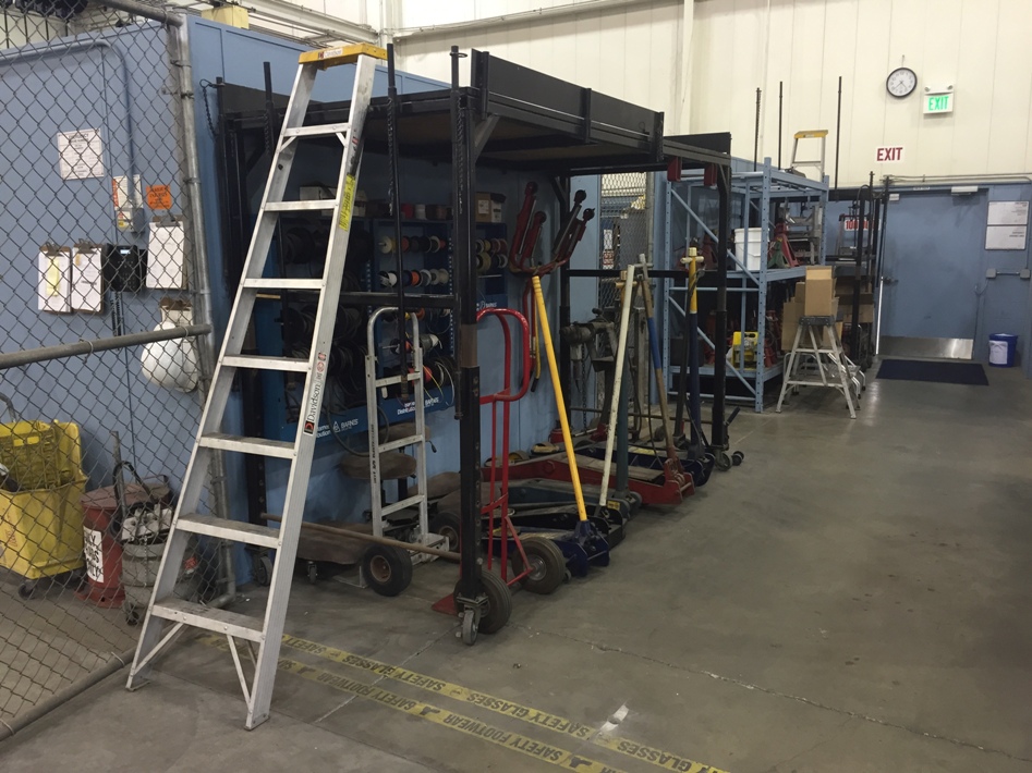

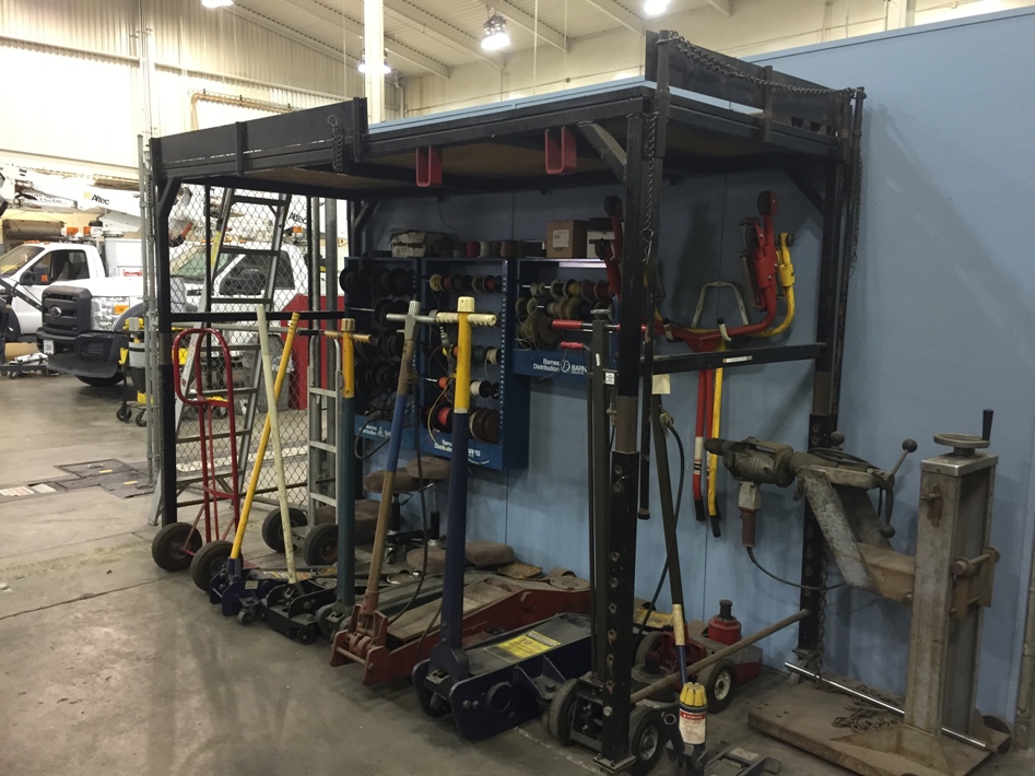

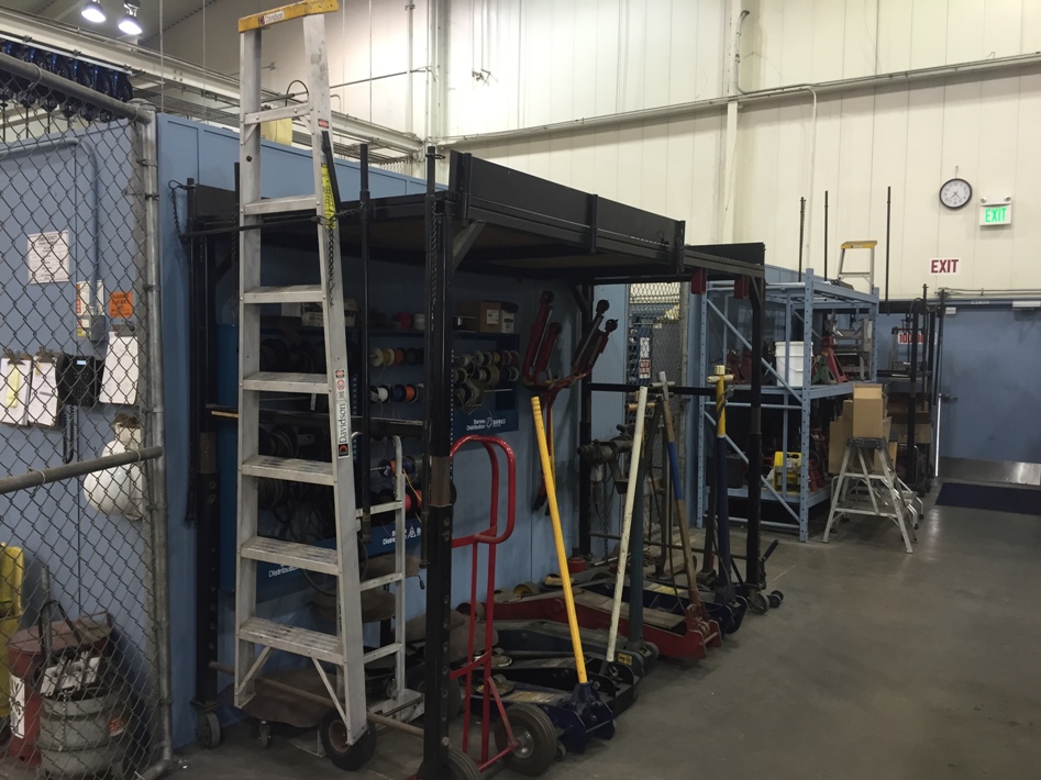

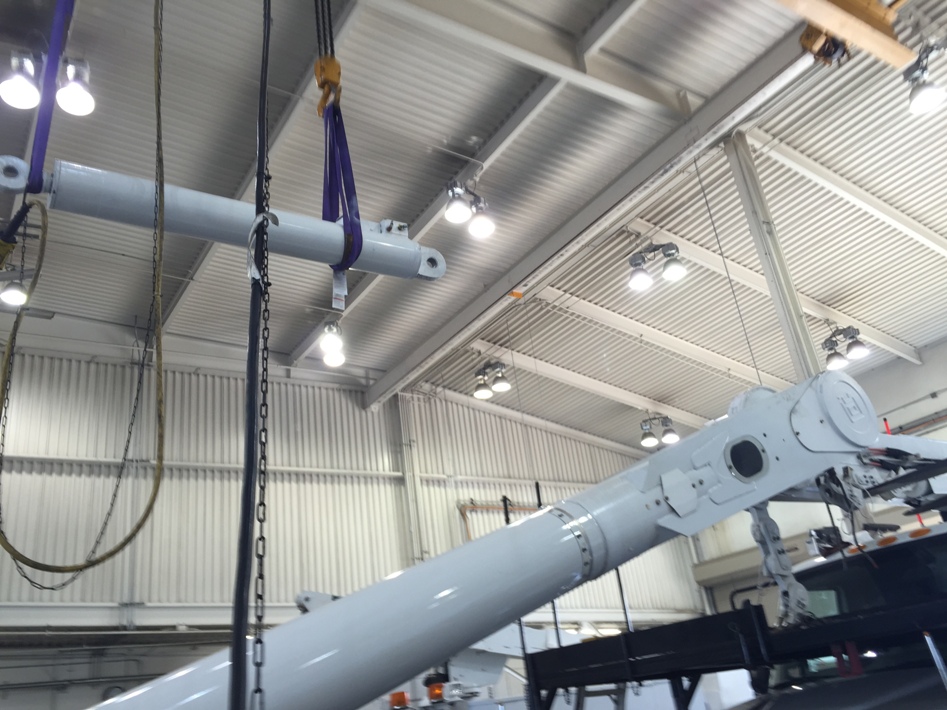

So, here's my story. I wish I would've taken pictures before I broke all this down but you should get the idea. I have a work platform that was made back in the 1980's. Made by the crew that used to build boom trucks. It is built of 2 x 2 x .250 tubing and is pretty stout. On lockable wheels so it is easy to move around. The platform is adjustable in height and has a drop-able chain railing. The platform area is probably 4' x 10'. I wish there was more support under the plywood deck but the 3/4" thickness supports my weight along with tools. Although it is a little oil soaked. To climb to the top of the platform, they took an A-frame ladder, removed the back half and attached it to the platform with brackets. I have used this tool for years and it has been inspected annually, although I'm guessing not real closely. This was an internal department inspection that the corporation retains.

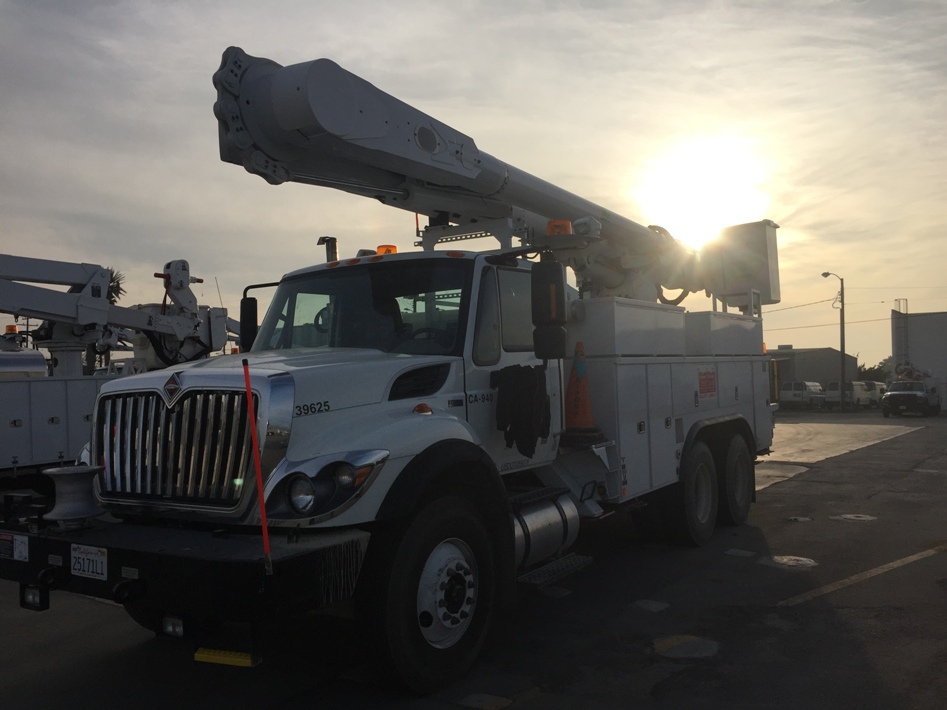

In recent years we have seen the rules change a little. Ladders must be unmodified and have the manufacturers tags for rating and such. Makes sense. I think this is the first time my current manager has seen this platform deployed. I had it in a position over the hood of a truck, just about right up against the windshield. This gave me a platform to replace the upper and lower articulating cylinders on this boom truck.
http://www.bunchobikes.com/scaffold4.jpg
http://www.bunchobikes.com/scaffold5.jpg
Yeah, the chains shouldn't be that saggy.
http://www.bunchobikes.com/scaffold7.jpg

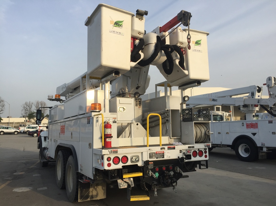

It also works great at the back end of a truck to do turret / bull gear / rotation motor work.
http://www.bunchobikes.com/scaffold6.jpg

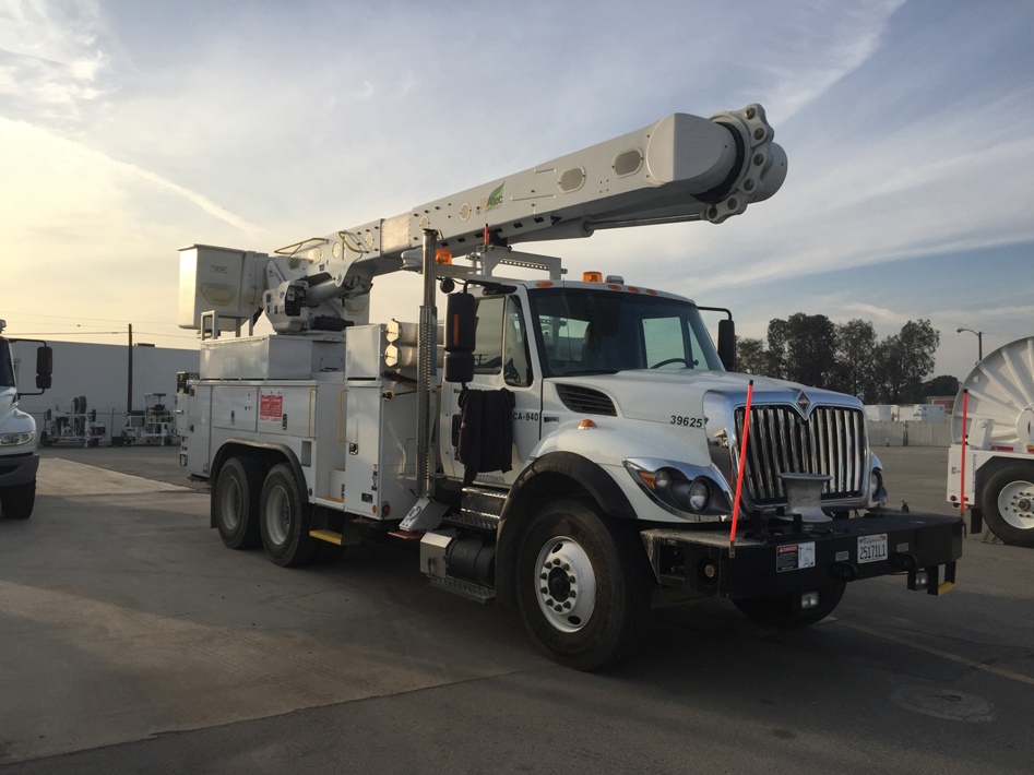

You can see the platform in place a little bit in this picture.
http://www.bunchobikes.com/scaffold8.jpg
