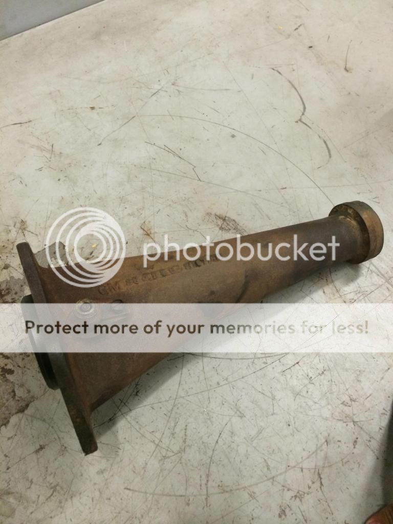

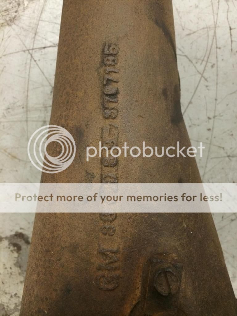

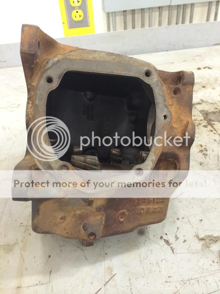

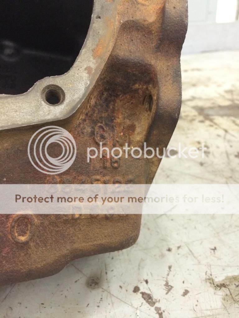

My Truck has a column shift so I'm guessing its a Saginaw 3-speed. I've looked through the search on this forum, Google and even called around to some transmission shops. The stamping or even the bolt patterns did not meet the ID criteria. I So here are some pics hope you guys can help me out.
Oh, and I'm rebuilding it in school that's why its all apart. My Instructor believes its a Saginaw. I just want to verify for sure.
Stamping on the housing
The housing itself
The cover and levers
Extension housing
Stamping on extension housing

This link will help you. Short answer is your instructor is correct.

What you have is commonly referred to as an SM318. While they were supposedly built at the Saganaw and Muncie facilities they are generally referred to as a Muncie. Anaheim Gear which is the source I purchase parts from here lists them in their parts book as a Muncie. The later full syncro 3 speed (7 bolt side cover) is commonly referred to as a Saganaw.

Fred is spot on. Easy transmission to overhaul, once you find the parts. If all you need are the gaskets and seals, Napa can get them.

Fred is spot on! This is what was referred to as an old Muncie 3 speed. Easy to rebuild and almost bullet proof. These are tough trannys. If you need more parts than just gaskets check drivetrain.com. They have all the hard parts for the SM318. Just look under Chevrolet/GMC trucks 1967 and older. Hope this helps.
