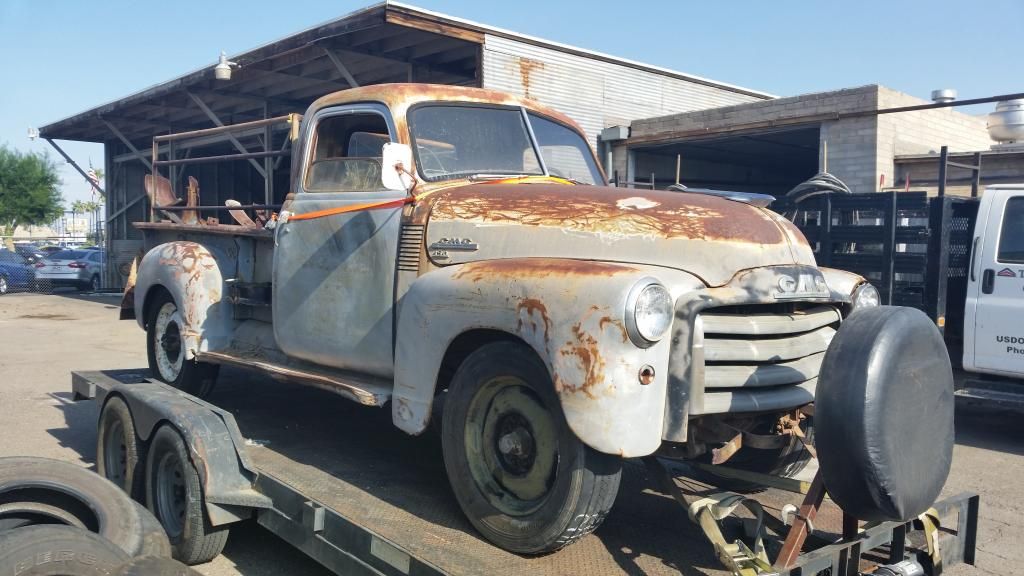

on the Internet for over 30 years! and not clogged down with Ads! Again, thanks! | | | | Joined: Aug 2014 Posts: 35 Wrench Fetcher | | Wrench Fetcher Joined: Aug 2014 Posts: 35 | Starting down the restoration trail... my truck has original 19.5" wheels, which look kinda "Tow-mater" authentic, but cant seem to find any leads on hub caps and wanna know what y'all think about going to a smaller wheel size?
Goal is a very original truck - for ice cream and social runs.
Thanks! GiG | | | | | Joined: May 2005 Posts: 8,878 . | | . Joined: May 2005 Posts: 8,878 | If you have 19.5" wheels already I'd for sure keep them. If you don't like them I'll gladly take them.

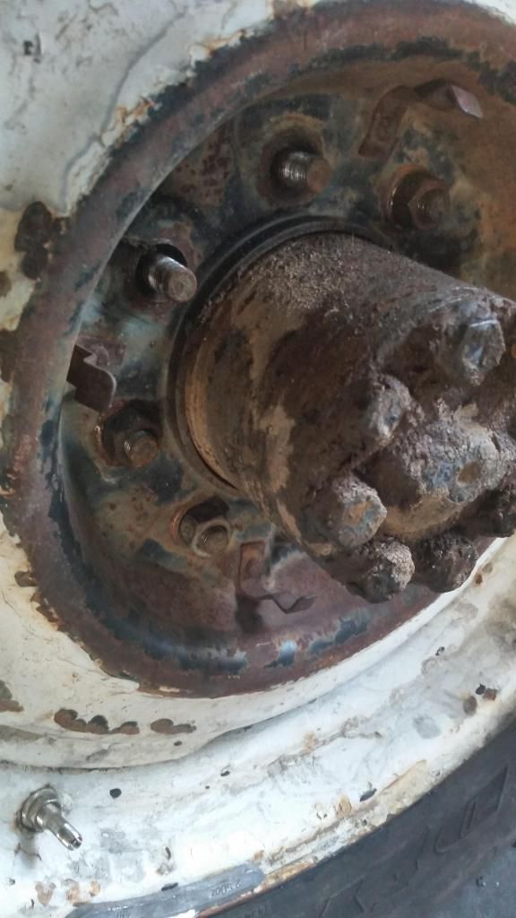

Will the stock 3/4 and 1 ton hub caps not fit? Do you need to install clips so they will fit? | | | | | Joined: Aug 2014 Posts: 35 Wrench Fetcher | | Wrench Fetcher Joined: Aug 2014 Posts: 35 | I really like the retro look of the 19.5, but the largest 3/4T hubcap I've found is like 9", which barely covers inner bolt drpression. Got no problem creating tabs, but just too small | | | | | Joined: May 2005 Posts: 8,878 . | | . Joined: May 2005 Posts: 8,878 | Do you have any pictures? I've seen 19.5" wheels with original AD hub caps on them, and I have some of those wheels with clips already. perhaps you have an odd/uncommon design 19.5" wheel? | | | | | Joined: Aug 2014 Posts: 35 Wrench Fetcher | | Wrench Fetcher Joined: Aug 2014 Posts: 35 | | | | | | Joined: Jan 2009 Posts: 1,644 Shop Shark | | Shop Shark Joined: Jan 2009 Posts: 1,644 | Go to Mikes hub caps they have the bigger caps just put a set on my 53 3/4 ton GMC,Baby Moons and they look great.
