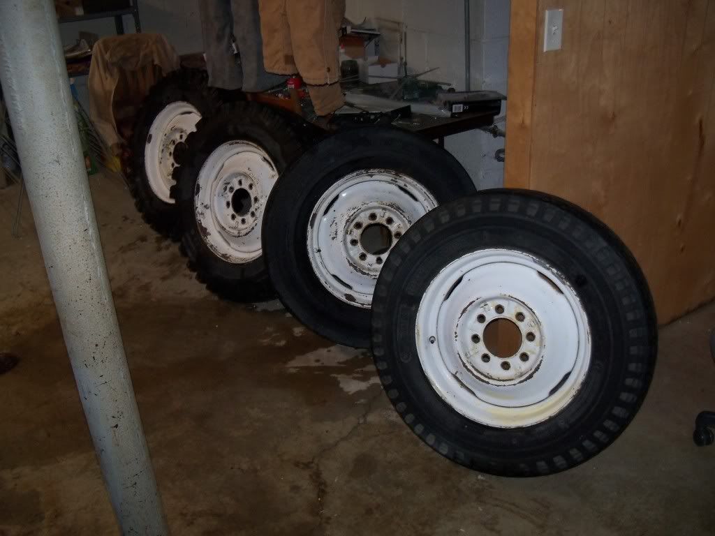

How tall do these measure, standing up? From the ground to the top of the Tire?

About 33" tall on these half worn 800 x 19.5 bias plies.
