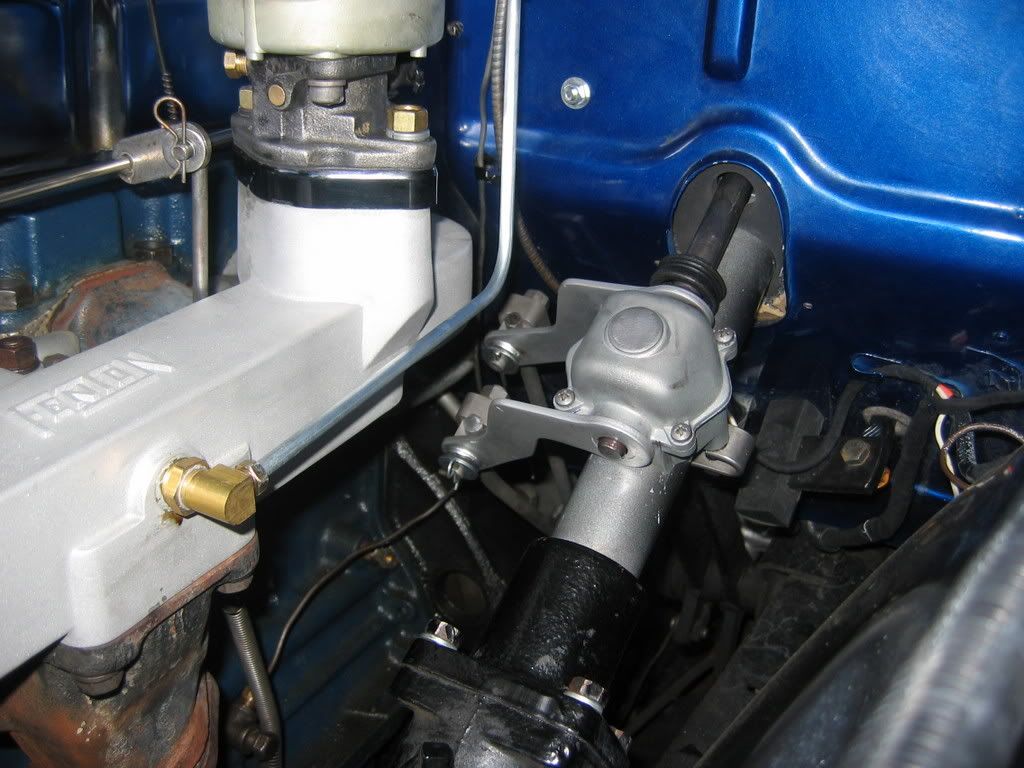

So after finally sorting out most of the problems in my 235 Chevrolet engine. I have discovered that the three on the tree linkage hits the manifold, is there any fix to this? by the way the truck is a 1951 3100 with a 235 engine

Sorry it's an offenhauser 2 x 1. The linkage from the steering column is hitting the intake. I've already addressed the fender support rod.

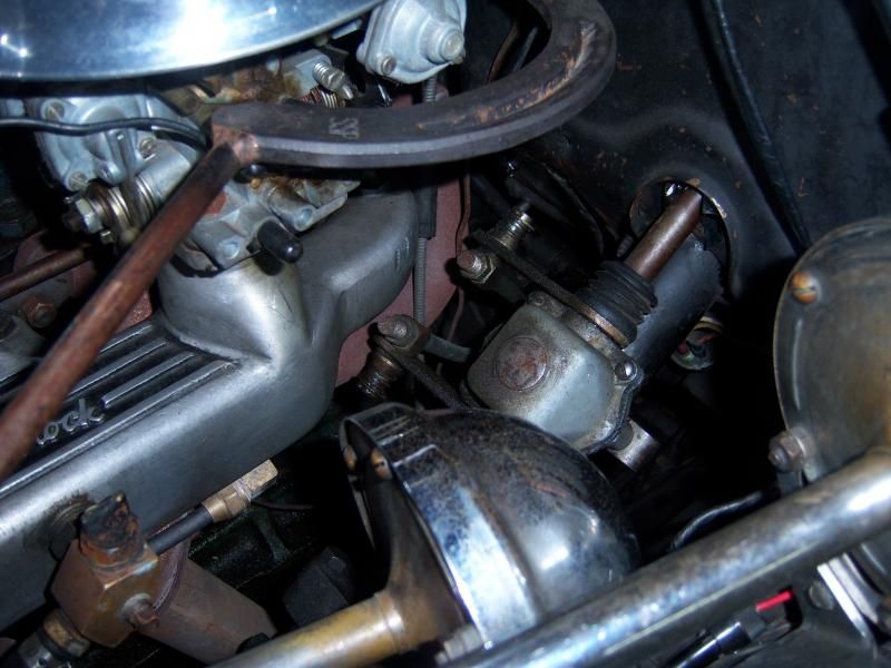

I actually went back to three on the tree about 7 months ago. I cut down one of the shift arms and added a new hole. That said, my Edelbrock is more curvilinear than your Offy.

Thanks! Do I have to remove the steering column to pull those shift arms?

NO, two small nuts on the underside, don't lose them. Measure, measure, measure, dry fit. Consult your owners manual for adjustment. One set that I did that worked well was to make up my own rods to the trans shifter arms using heim joints. Expect to spend a couple 8 hour days to get it right. PM me over the weekend if you get in a jam, or need a sanity check.

When you change the length, won't that change the throw? Also I feel like if I make one shorter I should do the same to both ?

I think we removed a 1/4" inch out of mine, could have done another 1/8" We had to bend the linkages a bit to get them to clear everything to the tranny, I also had to adjust on the rods at the connectors a bit but everything works good, I made a plastic one and tested it first. Pics below.
[IMG]http://i1321.photobucket.com/albums/u558/smoloney08/shiftlinkage4_zps9436809f.jpg[/IMG]
[IMG]http://i1321.photobucket.com/albums/u558/smoloney08/shiftlinkage3_zps3095eeea.jpg[/IMG]
[IMG]http://i1321.photobucket.com/albums/u558/smoloney08/shiftlinkage1_zpsa77e5fb9.jpg[/IMG]
